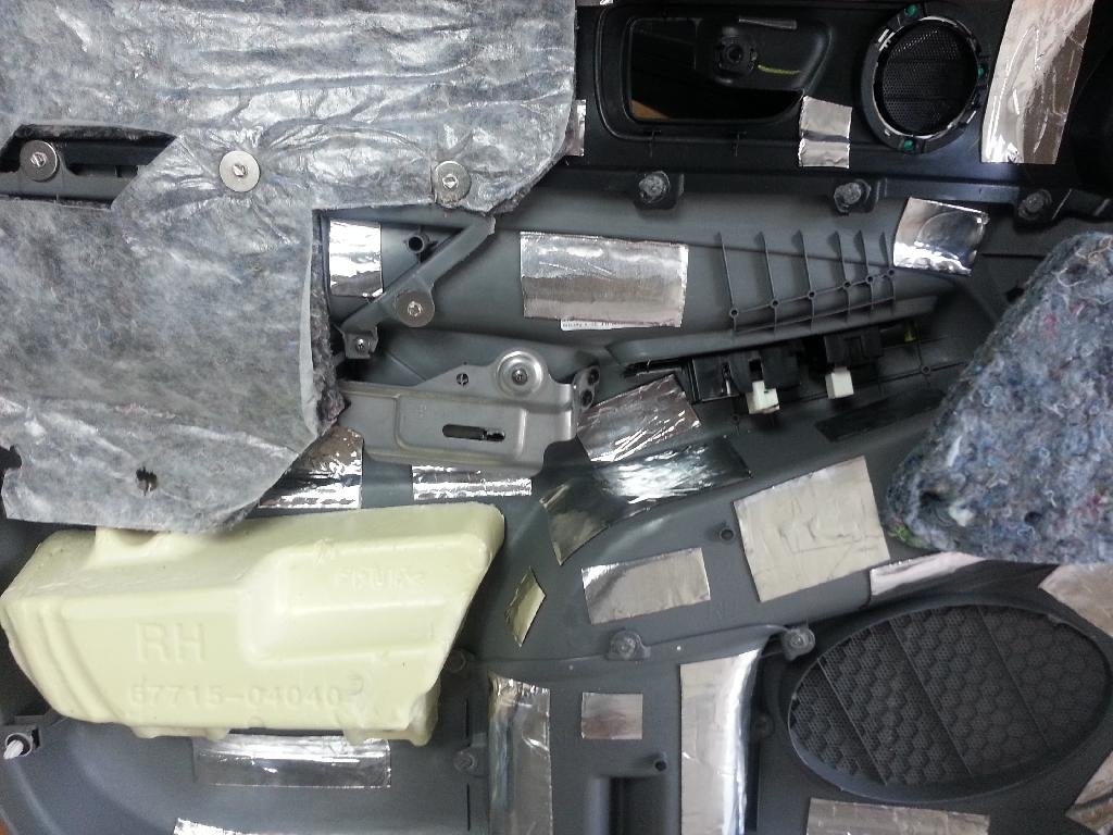

    I get really good bass IMO- enough where I installed anti-vibration material on the interior of the door panels to control vibration when it kicks in.
    I installed Polk MM6501 components in the front doors and MM651 coax in the rear doors (I got a deal on them). The adapters came from Mr Marv on here. I have the passive Polk crossovers connected that came with both.
    After replacing the Audio Control noise generator I bought initially with the Bit Ten, the audio shop told me they would suggest to just do the front with components and use the Bit Ten to control them w/o the passive crossovers. If I was going to do it all over again, I would start with the front and then do the rear doors if I needed more. With the Bit Ten, I have the rear speaker gain turned down a little which keeps the perception of the sound coming from the front.
    I would suggest using anti-vibration material on the door panel, its what's touching you and makes a difference in perception of sound quality. Don at Sound Deadener Showdown was the one who suggested it and it made a big difference. I would suggest checking their site for your research on material for deadening the doors. If I was going to do it again, I would have used much less vibration material on the doors, which helps, but isn't really designed to block noise and hung the sheet of mass loaded vinyl with CCF on top in the first place.
