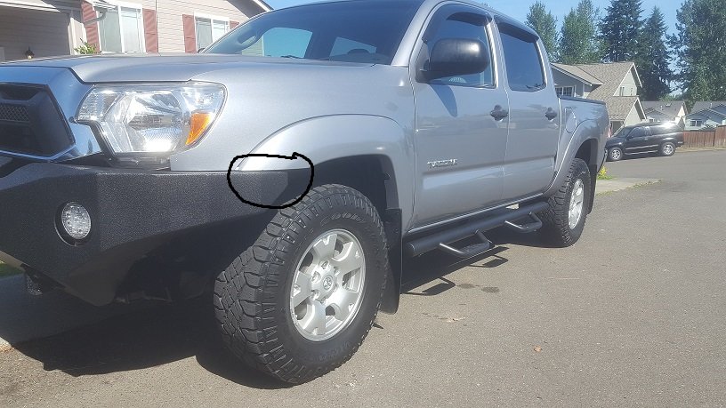

    Did some searching and couldn't find much so maybe someone else has experienced this. Bought my truck about a month ago and finally tracked down this annoying rattle from the front drivers side fender area every time i hit a pothole at lower speed (15-30mph). The rattle is literally coming from the fender i can feel it moving and rattling when i hit a pothole everything looks bolted up from the outside, haven't check under the fender liner yet but that's next. Can anyone share some insight or guidance for me on things too check for?

    It's definitely a rattle, driving over potholes i can feel something rattling in my fender when i put my hand on it out the window. I did check my body mount bushings, skid plate bolts, shocks etc everything looks good.

    So after spending a good hour trying too get the fender liner off i gave up, it seem i need too take the flare off too get the liner off? But that's the bad news the good news is I found this frustrating rattle, my truck has an aftermarket bumper and for some reason it was hitting and vibrating the fender flare! I found this by hitting the bumper with my knee when under the truck, I took a 1/2 inch thick piece of 3M double sided sticky foam and placed it between the bumper and fender flare.
