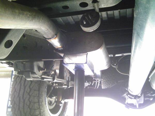

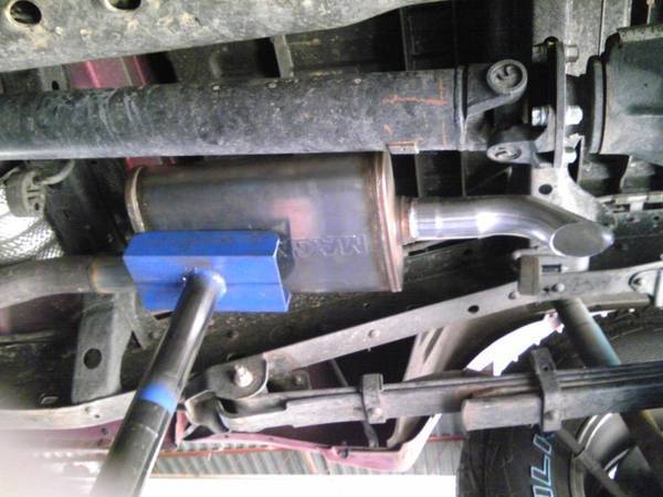

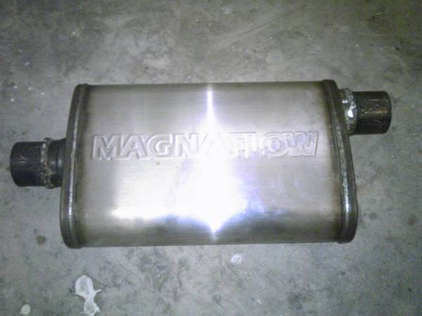

    Today I had both rear cats cut out, straight piped and 14" magnaflow 11225 center/offset 2.25" inlet/outlet put in with rear turn down. It sounds awesome! Nice and deep at idle and cruise with throaty growl when I get on it. This beats paying hundreds for exhaust system! I paid $35 for muffler and $40 for installation... Highly recommend this muffler! Now some pics;

    Yea me too! The shop didnt care about bad welds, he cut the pipe off and welded new pipe on... It all took less than 30min...lol

    Got it used from RMAN808...

    Ya man the muffler was in nice condition!

    It was done at Custom Mufflers at 12011 North 19th Avenue #3 Phoenix, AZ 85029. Quick and solid work. Welds look awesome, way better in person than in the shittastic cell phone pictures...
