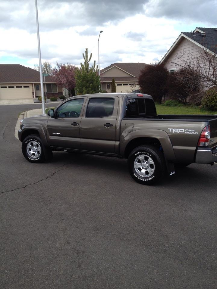

    Pic of previously mentioned brand spanking new Taco.

    Good looking truck
