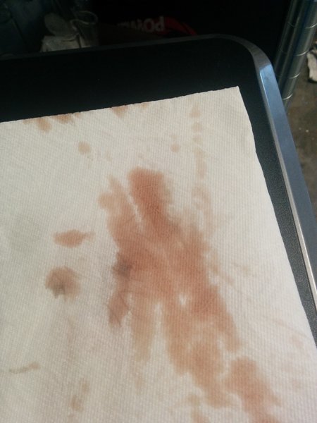

    good video thanks for posting it up. I just checked my fluid and its actually fairly pink still. Maybe I did do a drain and fill at some point. Possible to still be pink at 140k+? With that color would you be more inclined to do a full flush? Thx again really appreciate the input!

    Your fluid is not bad considering your mileage.
    Not sure if the Tacoma ATs have a drain bolt, my personal preference for an AT is an annual drain/fill. Keeps the fluid nice and pink.

    this has been a debate for awhile but most say drain/fill and avoid the flush. The AT fluid is designed to last a long time under "normal driving conditions", you know, driving downhill all the time haha.
    the manual also states to "check" the fluid and replace "if necessary." I say yours looks fine but keep an eye on it and when it starts heading more to the brown then do the drain. If you tow, travel short distances, or sit in bumper to bumper then you may need to do it sooner as these will wear on the fluid more than flat highway travel.
    if you look at the AT dipstick it actually says the fluid should last the lifetime of the transmission under normal conditions. but Yota peeps are never normal :)
