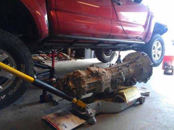

    I have about 107k and had to pull the trans due to it pouring fluid out right at the back of the engine and bell housing... Just dropped it off at the shop Friday, but am thinking its the front seal for the tork converter.
    Will also be doing my rear main seal while the tranny is out, both front wheel bearings, 4 ball joints, carrier bearing, and what ever else I spot.
