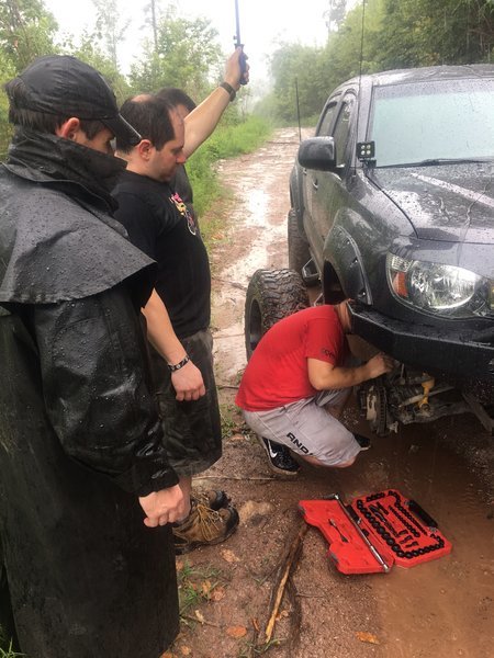

    @The Hunter fixing @joeybags brake issue (mud stuck under the pad).
    Of course we had the wheel off about the time it started pouring.

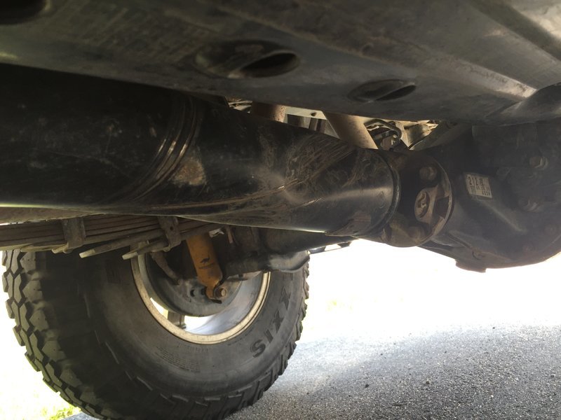

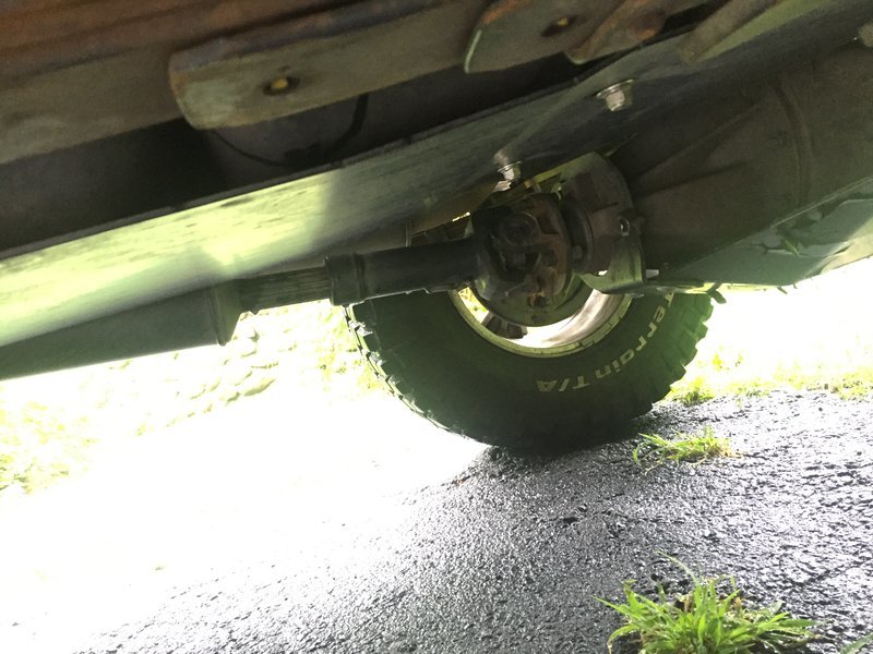

    I'd say: Yes, it's both :)
    May as well get a 1 piece shaft.

    Ill look into this. Just from a quick google search, im finding a replacement to be $600+. How much would a 1 piece be? Estimation?

    @jowybyo does yous look like mine??

    Yup almost exactly.

    Yes, I'm sure that's the cause of your vibes. My one piece was $573.

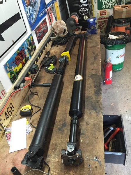

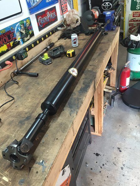

    Here you go. I copied this from my build thread:
    I picked up the new one piece driveshaft and threw it in after work tonight.

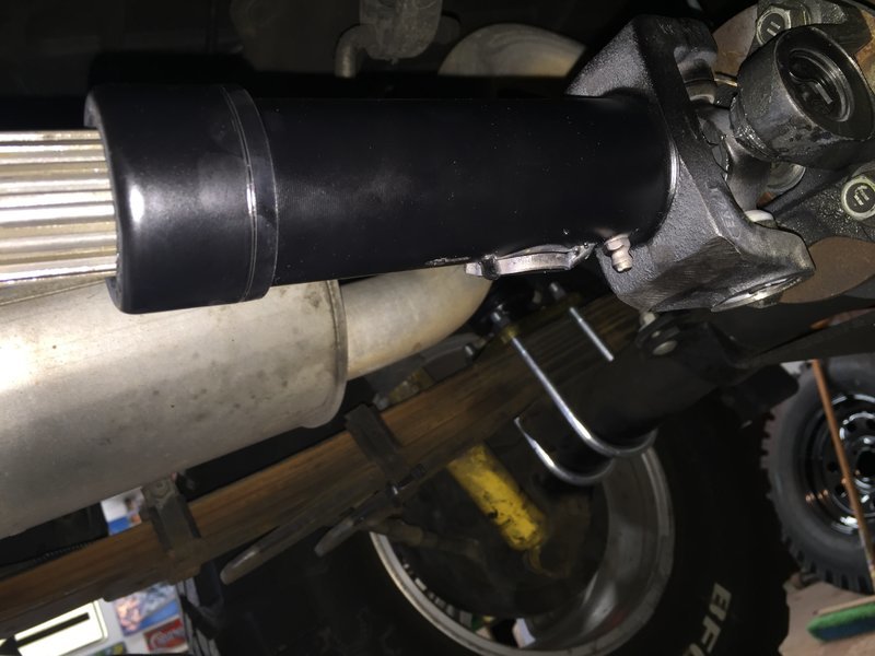

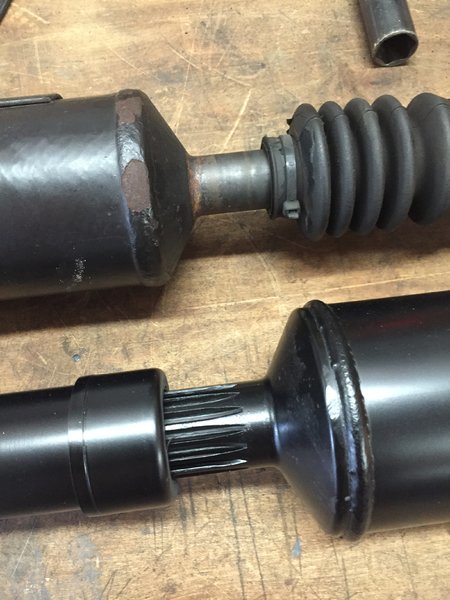

    The shaft is 1/8 inch thick steel. Look at the difference in the slip joint diameter. I didn't measure, but it's noticeable.
    I also had them use a slip joint that was splined the entire length instead if the normal couple of inches. Hopefully this will keep any high speed wobbles at bay.
    The slip joint is also greasable

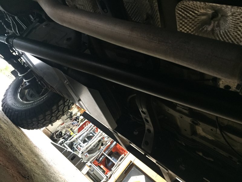

    Installed

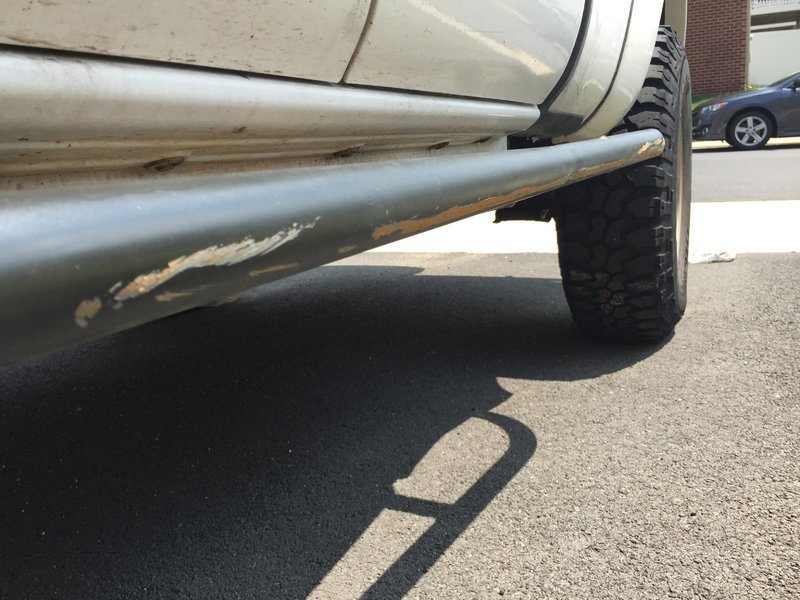

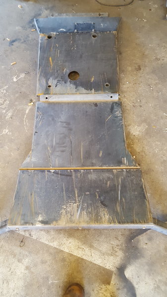

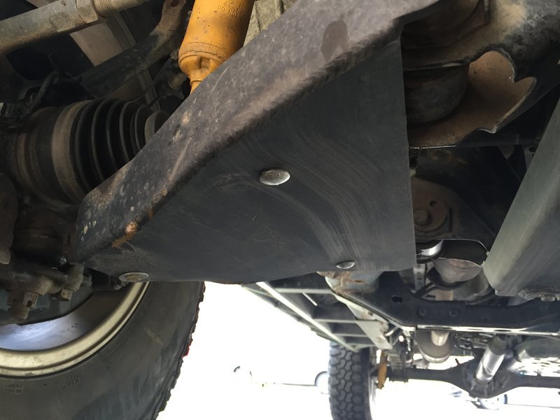

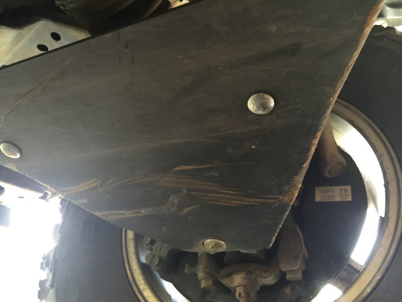

    Thanks for leading us through hell and back! It was unreal. I ripped a CV boot, banged up sliders pretty good, and dented all 3 of my skids. And it was worth it!
