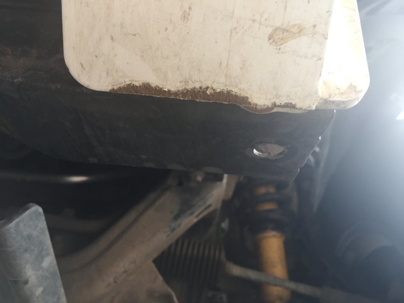

    I crunched my pretty white bumper after all.. :facepalm:
