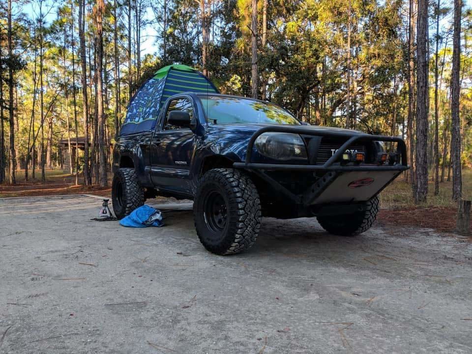

    Most of us use aftermarket rims. Granted I'm a 2nd gen. You just need to get your numbers right for the specs. Here's mine on 33s with cragar soft 8's which are 15"

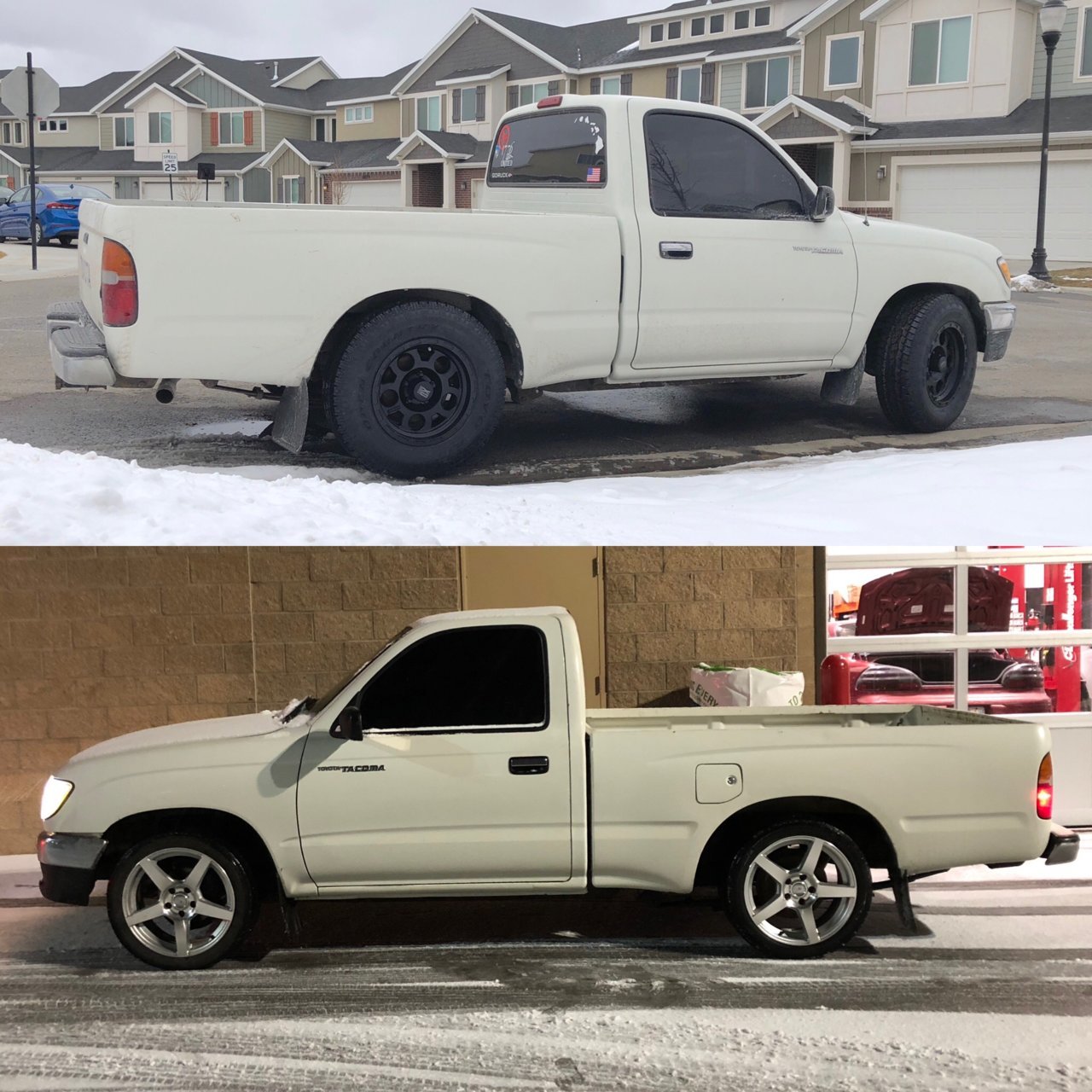

    Update! 15x7” -9mm offset XD enduro wheels w/ 215/75r15 toyo AT (they clear the rotor) truck has 2” rear drop. They rubb on the front fenders when I hit dips. 1.5” level coming soon!
