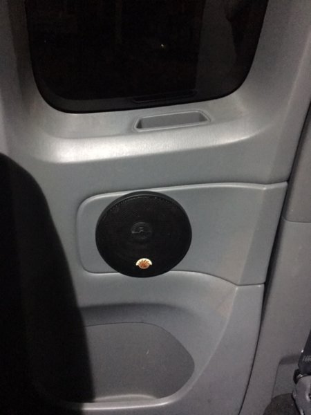

    I had the spot in the door frame, but had to create a new speaker opening in the plastic panel. I wanted to get a black fiberglass grill, but opted for a much less expensive and labor intensive route: installing a speaker grill over a 5.25" hole.
    EDIT:
    I ran speaker line from my aftermarket amp through the back doors to power them. Eventually I will run the fronts with amp too, as soon as my buddy who is helping and I can get together to do it.
