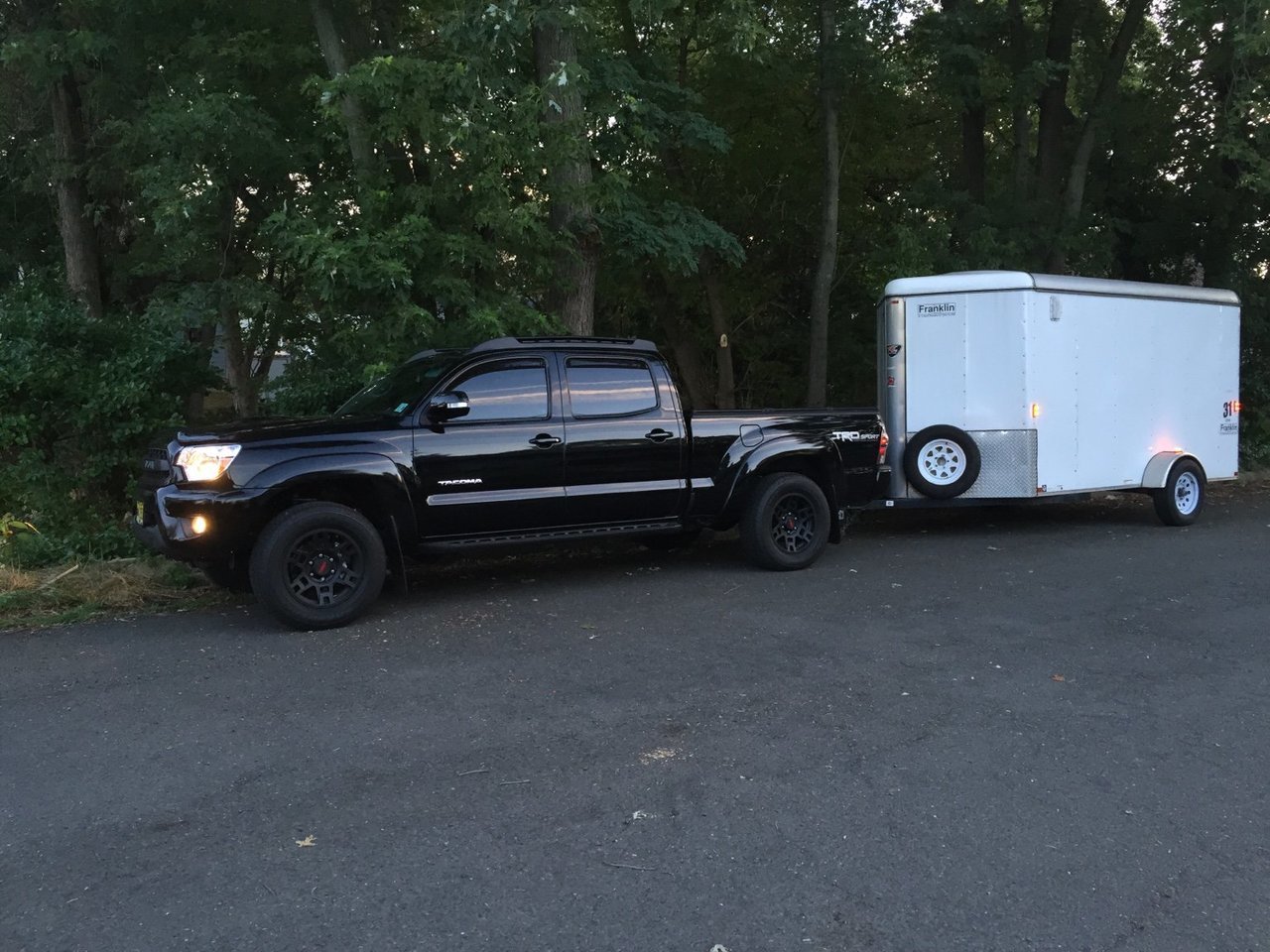

    Hey suspension gurus, got few questions related to general suspension upgrades (or as many refer to as a lift). To make this more complicated, I also tow a loaded enclosed 6x12 v nose trailer, which causes Taco's rear end to sag. I am new to trucks, lifts, suspensions and towing...so be gentle lol
    Here are my questions and any and all help is greatly appreciated.
    1- I want to improve my stock Trd sport suspension handling, while lifting/leveling the truck approx 2.5". What are good options for such kit? OME? but which kit?
    2- Would installing the above referenced kit require me to upgrade to aftermarket control arms?
    3- what are my options for addressing the rear end sag (not a whole lot but you can see it the photo below) while towing? Should I be thinking about air bags or rear leaf helper? Or will the upgraded suspension take care of the sagging issue?

    I'm not n expert, but a couple thoughts:
    In your picture it looks like your front end high with the trailer attached. This means you've compressed about 2" out of the rear (taking out all the rake)
    If you lift the front 2" you'll look really funny with the trailer attached, and the handling will suffer.
    Either a new leaf pack, or air shocks will solve that issue. Air lets you adjust ride hight, and can take more weight than anything else in the truck. New leafs will give more lift with the trailer weight off the truck, and bring back rake.
    There are a couple long threads around here on the leaf pack vs air ride trade off. I'd start there.

    No, I'm saying if you lift the front you must lift the rear somehow to handle the trailer load, or we very front end high witb the trailer on. Air bags will let you adjust the rear lift, so you can be level all the time. New leaf packs will result in rake when you take the trailer weight off.
    My truck has 2.5" front lift, 4" rear lift, when empty. But will be close to level when I add 500lbs of hunting/camping gear. I went with leaf packs thinking them better for offroad use. I'm not sure I'm well enough informed on that tradeoff to offer advice.
