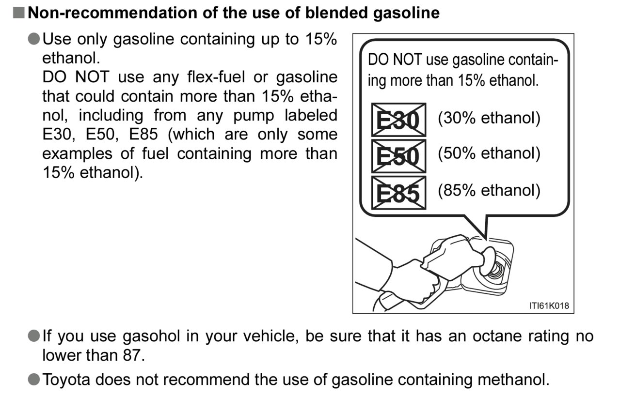

    From the Toyota manual
    ● Use only gasoline containing up to 15%
    ethanol.
    DO NOT use any flex-fuel or gasoline
    that could contain more than 15% etha-
    nol, including from any pump labeled
    E30, E50, E85 (which are only some
    examples of fuel containing more than
    15% ethanol).
    FYI
    All vehicles made for sale in the US since 2001 are required to run on E15

    Good thing the owner's manual also tells you
