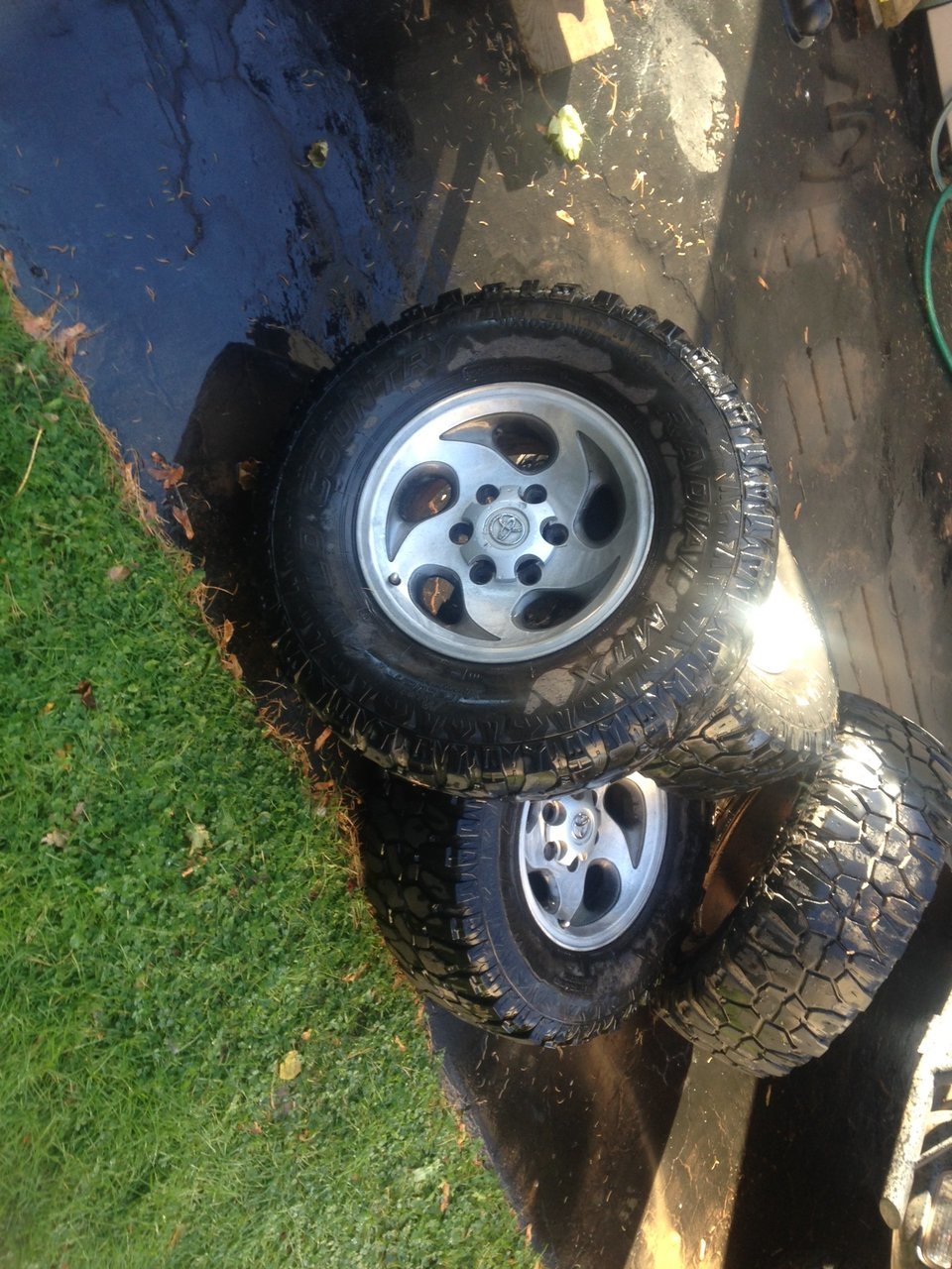

    hey guys. so my tacoma is all back together. im able to run and drive it! i have one question. i currently have 3 15 inch rims and 1 16 inch rim on wy truck because when my buddy rolled it, he bent a rim. im looking for a stock 15 inch rim. i keep seeing everywhere that 15 inch rims will not fit due to calipers.. except i have drum brakes on rear. i measured the distance from the drum and inner edge of 15 inch wheel and i have 1/2 inch or so. on the drivers side where i put the 16 inch wheel i have an inch of room. i want to keep the 15s because i have like new 32x11.50r15L mud tires. im looking for a 15 inch rim without offset for the passenger side rear... my other truck has 2 inch wheel spacers i could use but hate to. the 3 15 inch wheels i have is 3/4 offset. but a factory 16 inch rim fit fine with plenty of room. my question is, will a stock non offset 15 inch wheel work?
    the reason i want non offset is because my axle isnt 100% aligned so its pushed to the right about 3/8 of an inch. my local body shop said they can fix that for 2 grand... i paid 300 for the truck and spent about 500 in parts... either i cut and reweld spring perch or i live with it. i only used the 16 nch wheel so i could get it inside my garage. the parts truck has 16 inch s10 wheels. 2 aluminum and 2 steel. i dont want those. ide like to keep my mud tires

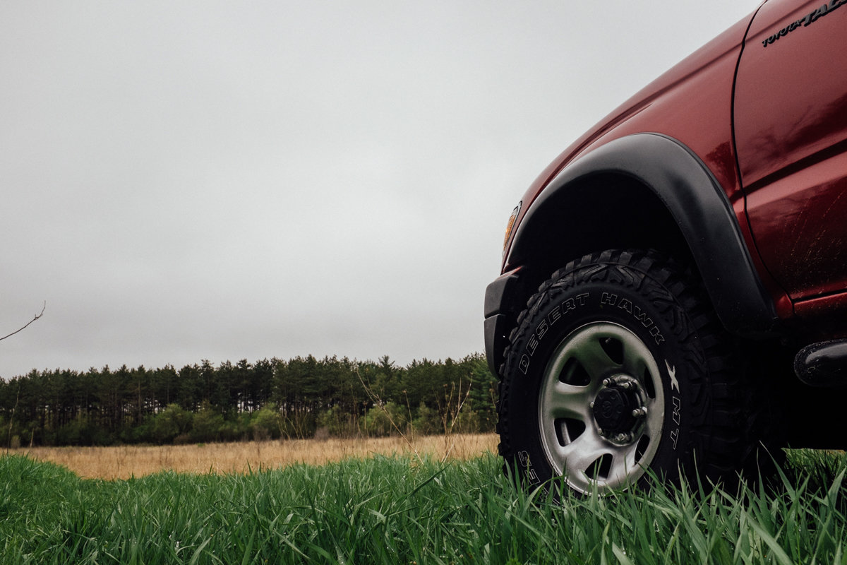

    Have personally run this style of factory wheel on my 2004 DCSB, 4x4:
    Danno1985 likes this.

    if you run a "Toyota" 15" rim you will be fine. some aftermarket 15" rims will not fit any Tacoma without spacers. but OEM is always the way to go if you can get them
    :D
    Seagull233[QUOTED] likes this.

    thanks for the responces. i have 15 inch 3/4 offset rims. the "look" as if they would clear without the offset, i cant find any factory non offset 15s anywhere near me. i called toyota in white river junction... they want 220.00 for a new factory rim. i have 1 aluminum rim at work but i have a feeling its thicker material so it may not fit. i plan on bringing just the rim home and test fitting it. i hate to have 3 steel and 1 aluminum but i cant find any. i havent tried craigslist yet. i will keep you guys posted

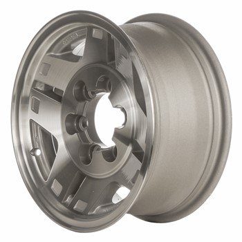

    These came on my truck from the factory, apparently. You can find refurb ones on wheelsandcaps.com for pretty cheap.
