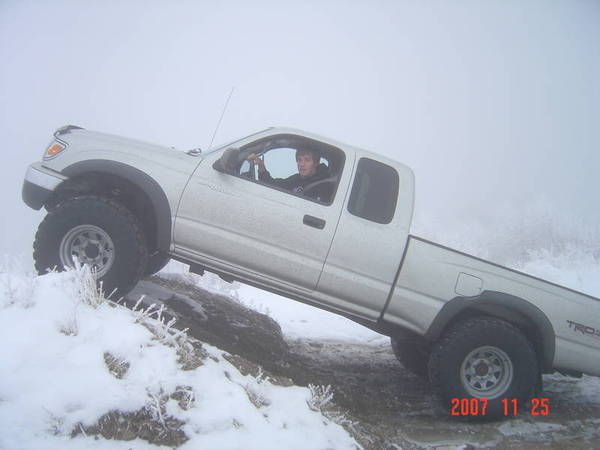

    here is Tacoma02TRD's truck with 3" revtek and 33/12.50/15 Bighorns:

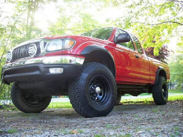

    With either the right wheels, or spacers, it can be done. The problem with the 15" wheels is contact with the brake calipers. I had 15" Cragars with 1/4" spacers. A lot of people will tell you those 1/4" spacers are no good. I can't say they are wrong, but I never had a problem.
    15" Cragars with 33/10.5/15 BFG AT

    I bought 15x8s with 3.75 in back spacing, they contacted the calipers. I ran spacers, but it's just to dangerous, wheels fall off that way.

    Yea i have a 98 i got 15" steel black wheels and the calipers are in the way. I am still deciding if i want to go the spacer route or what. Idk.
