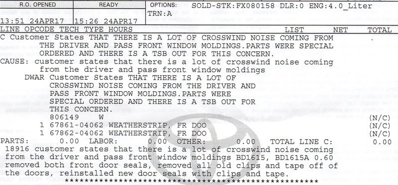

    First, I need to give Props to ramonortiz55 for posting the TSB. I've had the awful "Kazoo" noise for 2 years, mines a 2015. Went to the Dealer, TSB in hand, they ordered the kit. Took 4 days to get in. Just got back from the dealer and have to say no issues. Yet. First impressions, front doors close a bit harder with the new weather strips. Not bad, I just notice a difference. I'll post back in a few weeks with results.
