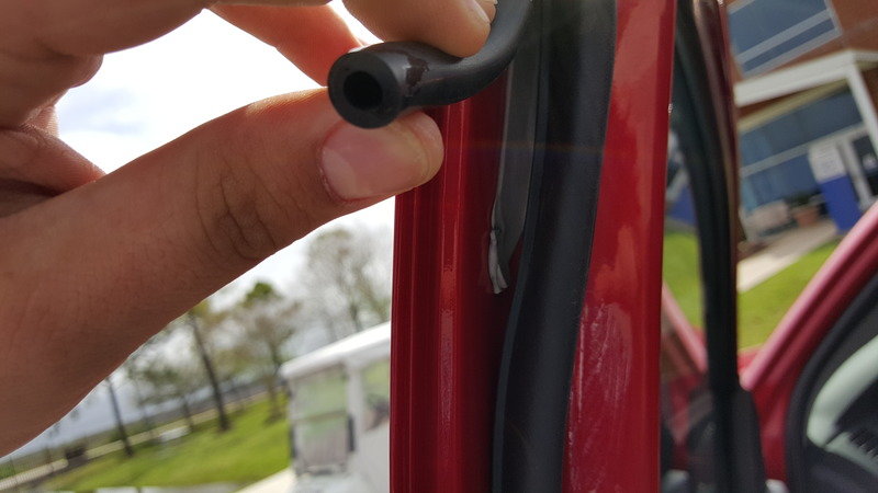

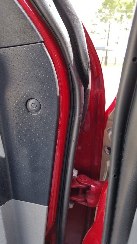

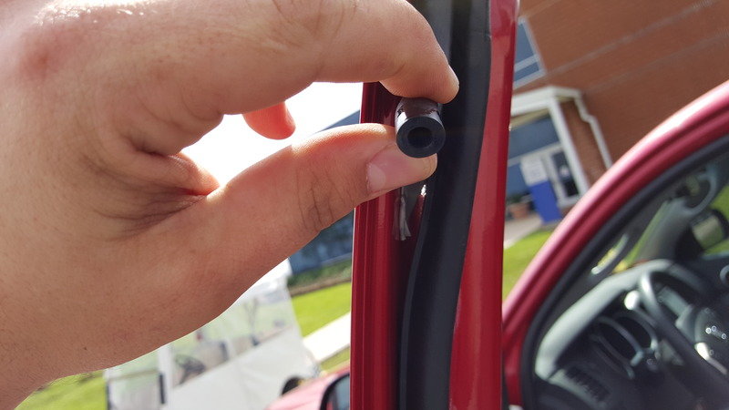

    As you can see from the photos, they pulled the seal back away from the door, used some 2 sided sticky foam tape to get the hose to stick. They then started near the top of the trailing edge of the door, went all the way across the top of the door, and down the leading edge almost to the top door hinge with the tape and tube, then put my door seal back in place. I have absolutely no squealing now, no noise, none, gone. I am a happy camper, now I can patiently await the new and "improved" door seals to be released.
    Told you guys that not getting this fixed wasn't an option for me. I am the type of person who is kind, yet persistent when I have an issue that I need corrected. I've found over the years that getting mad and yelling at people gets you nowhere, writing bad reviews on YELP with no facts and only badmouthing a business will get you nowhere. Rather, document everything, the persons name, the date & time, build a strong case with a lot of facts not accusations. Then, once you have tried everything, take all of the documentation you have collected and put it in the form of a kind, yet well worded e-mail or letter, send it to the top person at the company and ask to have the situation corrected. In my experience 99% of the time you will find a manager that can fix things, or that will help you get to the right person to correct whatever the situation may be. In my case I was lucky to finally find a manager that had worked with Toyota engineering and was able to not only fix my truck, but made me a lot happier customer in the end.
    Good luck guys, if you try this fix and it works, please drop a comment and let me know that it worked, just curious to see how many this helps.

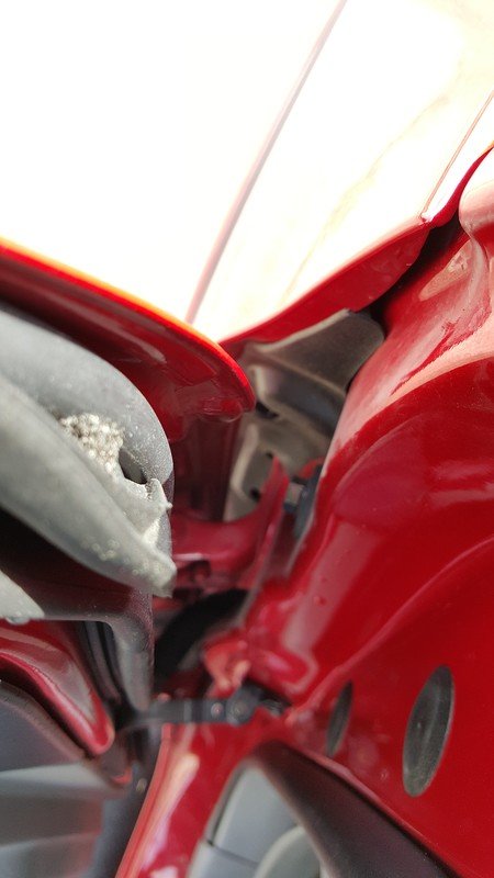

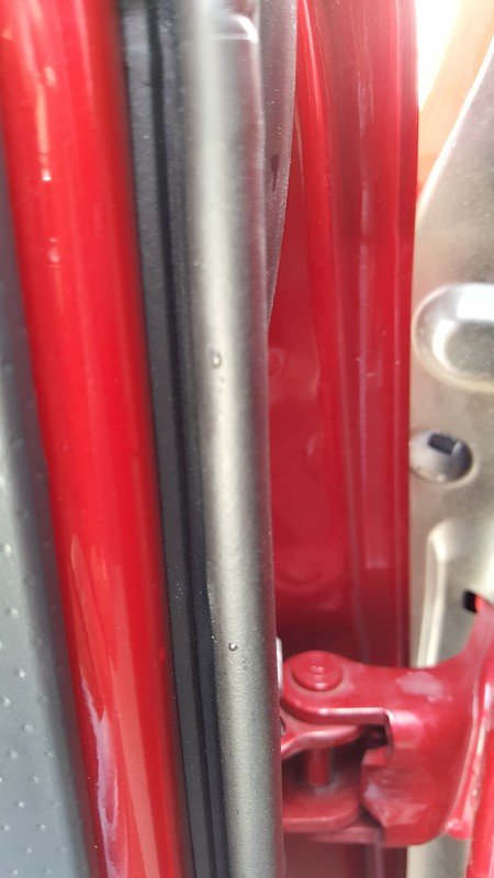

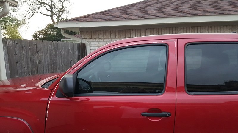

    I tried taking some pics further back, but it was too hard to see what was done that way too. Tell ya what, when I get home, I will snap a few more pics, I will also get a pic of the outside of the door and use paint to draw some lines showing where the tubing is ran, it sounds more complex than it really is.

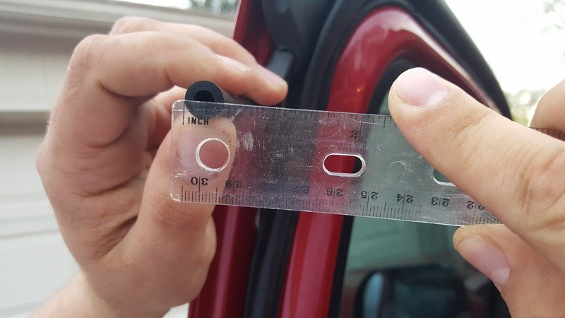

    I was wrong on the tubing size, it's 7/16" OD tubing, hopefully no one has ran out and bought the wrong size tubing already. In the second picture I drew a white line on the top area of the door down to the front, the line represents where the tubing is ran. Basically pull back the seal on the outlined area of the door, put some 2 sided foam tape in there to hold the tube in place and then sandwich the tube in there between the door frame and the door seal.
