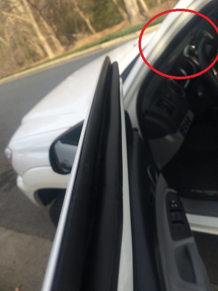

  9. Mar 23, 2016 at 3:23 PM
    #129
    rottenpixies
    rottenpixies Well-Known Member
    Aug 19, 2015
    #162178
    491
    New York
    2015 DCLB 4X4
    I did that exact method to the door seal on the cab like he does in the video. I'm planning to do similar to the seal on the door. Only issue is there is no cavity to fish the tubing into like on the cab side. So will have to cut a slit into it or something like others here stated.
    It made the door sound way more sturdy when its closed but didn't do much for wind noise. Hoping doing it to the door will improve it. I think I will do OPs method with tape behind the seal before cutting it open and trying to fish it through.

    #131
    rottenpixies
    Aug 19, 2015
    #162178
    491
    New York
    2015 DCLB 4X4
    The driver weatherstrip seal attached to the truck side instead of the door.
    This one
