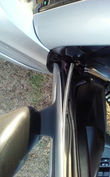

    The KAZOO sound from the driver's side drove me nuts. Here's a pic of my fix. 20161215_160326.jpg
