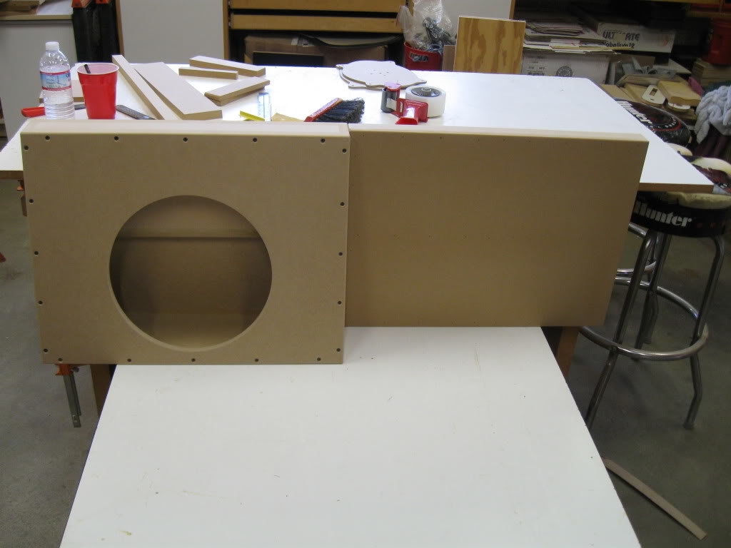

    That is correct buddy :) and another issue in this case is the diameter of the sub since the enclosure is angled (the larger the sub the smaller the mounting depth available). Also, you have to build a channel into the back of the enclosure in order to fit around the brace on the rear wall so a 15 at that depth will not fit without some serious surgery. :eek:
    Edit: the pic below is a DC enclosure for a 13" JL 13TW5 at 2.5" deep with a 12.5" cutout and the channel seen through the sub opening just barely clears that subs basket.
