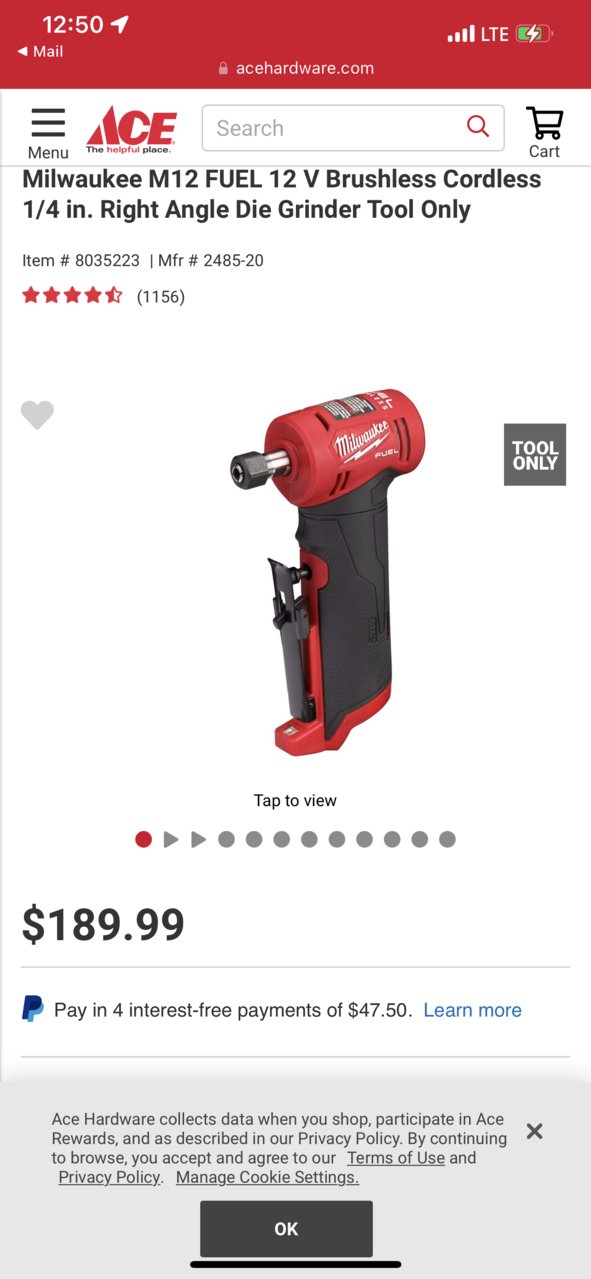

    I bought 2 extra nuts that I’m going to use to lock the main nut in place; hopefully that’ll discourage it coming loose.
    I’m thinking of a reciprocating saw too; but an a small angle grinder may work also? Thank you.

    Second nut would also work. I dont know if a grinder like that will fit in there.
