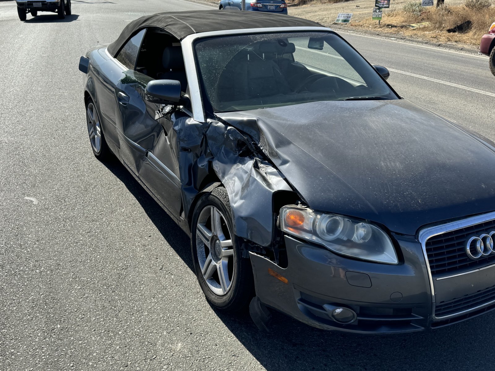

    Is this going through insurance? Regardless I'd have the frame measured on a digital measuring system like car-o-liner. It can measure for height, sway or short condition. Visual inspection can't guarantee you don't have frame damage.

    That old Audi was an economical total loss before you guys crashed.

    Definitely pushed the core support back. That's why the grill/hood are misaligned.Possible condenser/radiator damage.
    Good luck with the insurance company.
