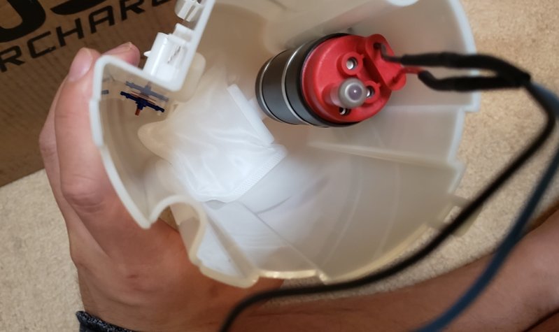

    They did away from them in the 2nd gens. To this day I don't run one on my boosted setup after replacing my OE pump and just run a strainer. No issues whatsoever, but I run an AEM retrofit pump in mine so it's worlds better over OE. I run mine til the light comes on and go fill up. Usually by the time I fill when it gets to the light that's 17.4 - 17.6 gallons. Leaving 3.4 - 3.6 gallons in reserve based on their 21 gallon fuel tank spec tank.

    Are you saying you delete the mesh filter and ran a strainer on the AEM?
    If so, maybe OP would consider this an option?
    I know it’s a BAD idea, but of course, e being me, the did wonder what would happen if you left the filter off? And run an external filter? Again, it was just a thought, I don’t even know if it’s possible. I’m sure one day I’ll find out exactly what all is involved with the pump and replacement. No way I’m trading trucks with the prices of them now. I’ll be driving mine for a long, long time. (Hopefully :fingerscrossed:)

    The mesh filter and the strainer are one in the same to me. I have the ability to run more options in there because of the housing delete I had to do to the module internally since the stock pump is no longer in there. The setup I run is actually a large filter made for a Toyota Highlander if I remember correctly. It's way larger that little pillow the stock setup has so it has more space to run fuel through before it clogs. I'll see if I can find it, though I know I've posted it in my blower thread. Hang on.

    @TnShooter 68021 Bosch. Fits a 2009 style Toyota Highlander. It looks to be cotton but they labeled it a strainer.
    Also, I would never run the pump without some sort of pre-filter. One large piece of debris gets lodged in the pump itself and you might as well kiss the pump goodbye and maybe even your engine.

    I see, so you modified the housing.
    As seen here?

    Exactly. That photo includes the exact pre- filter setup that I mentioned above which I suggested in page one of my thread and was taken by one of the members who actively participates in there.

    I found that picture by searching for “fuel tank pump baffle”
    At one time, there were pictures floating around here of the process and the “box” the pump assembly goes in. I haven’t been able to find them since.

    I do indeed. I haven't seen it in a while because it gets lost in the useless nonsense and drivel that is posted here (light bars, tires, Friday threads and what have you) but it's here somewhere if you look hard enough. That box you are describing is labeled a module by the way.
    I know it's one of my guys setups because if you observe closely you'll see a box in the background that says US in capital letters and rgchar below it, Magnuson Superchargers. That plus I know of one or two guys who did the retrofit who is running Aeromotive Stealth pumps in their setup. Lol.

    See there, i already learned something.
    I would never have guessed it was a “module”.
    I would have called it a “baffle box” :rofl:
