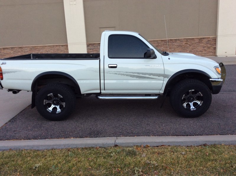

    If i just gave up my desire for the beadlock look then the Pro Comp 69 vintage styles are like $100 a wheel right now, plus theyre -12 offset. Or B&R has an A grade set of used Ultra Type 164 right now for $300. I just feel like they fade into the tire too much without the extra splash of chrome on the rim.

    I would say just get some steel wheels, usually pretty cheap. Unless you find a deal on something. I honestly can't say I'm in love with my wheels, but they are the right size and offset, so I choose function over form. There is plenty of other things to spend money on than fashion Imo.
    Also if you wheel alot, a smaller rim gives you more tire side wall to soak up the rocks. Larger rims clear bigger brakes, so its a trade off. Since I already had 15" rims and my friend donated 35" tires, I couldn't get bigger brakes, so I upgraded my brake pads to Ebc Yellow Stuff. More bite and fade resistance.

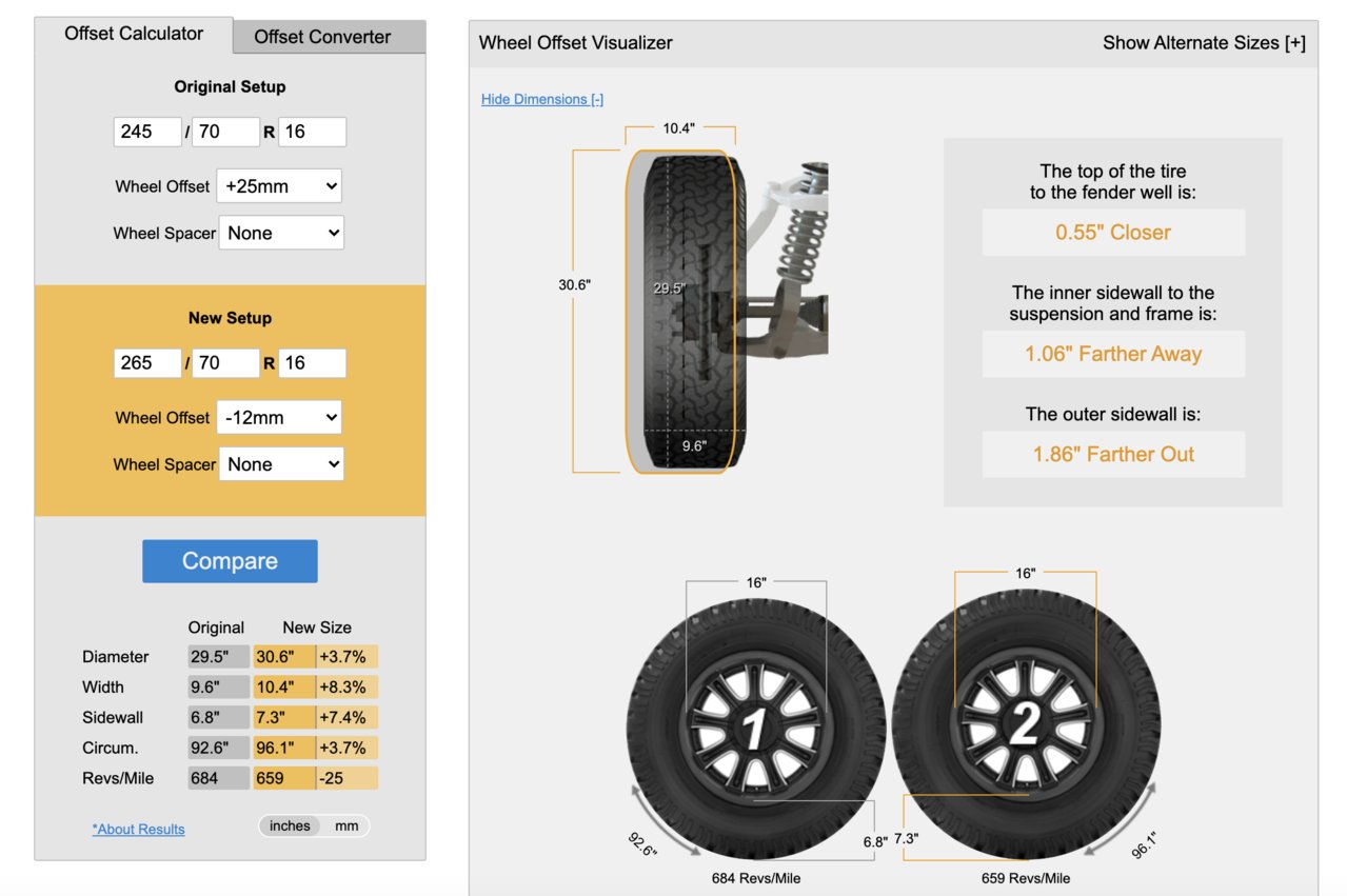

    Ok I just found this tire size/offset calculator which is immensely helpful. I've seen a few good tire size calculators but this one actually shows how the tire will ride in the wheel well which I had never seen before. Mind blown! haha.

    Ok so I went with the 16x8 Pro Comp 29 and am sticking with my previously purchased 265/70/16 Wildpeaks. Foregoing the spacers for now and just gonna see how a slightly wider tire and wheel at a zero offset rides.
