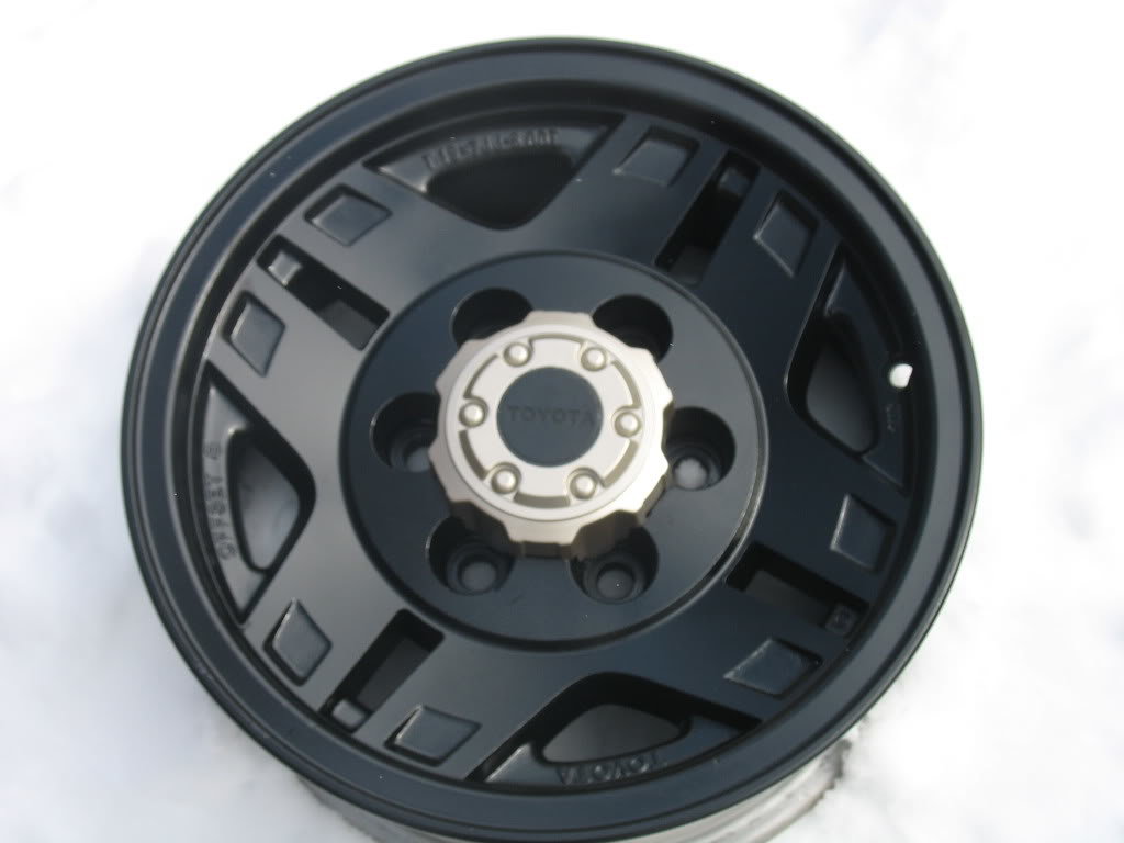

  11. May 3, 2011 at 8:30 PM
    ontarioyota
    ontarioyota Well-Known Member
    Oct 2, 2010
    #44122
    1,330
    @scott777taco INSTAGRAM
    SW Ontario, Canada
    2001 Reg Cab 4x4
    Blacked out badges-rims OME lift with 881's & dakar pacs, summer tires=BFG 31x10.5x15 on 93 4runner rims,winter= 265 75 16 DURATRACS on stock steelies,Flowmaster exhaust, deck plate mod, ARB front bumper
    These fit my 01 4x4.....15 inch old (1993) 4runner rims.
    16 inch is stock size but no caliper issues at all.
    Mounted 31x10.5x15 tires on them to equal stock tire height.017_f38fd0738dde267102d7e99a17f3bf1f654df037.jpg
  12. May 4, 2011 at 4:28 AM
    mx04taco
    mx04taco [OP] Well-Known Member
    Dec 4, 2009
    #26990
    170
    Cory
    Marietta,GA
    04, SR5, TRD, 4wd
    Flowmaster exhaust, Pioneer DVD HU, Pioneer speakers all around, , Viper security w/ remote start, Tinted Windows, Silverstar Headlights, Toytec 3" Coil Springs, All Pro Offroad Diff Drop 3/4", Bilstein 5100s, 2" Toytec AAL's, Toytec poly rear leaf bushings, Deckplate Mod 4", 265/75r16 firestone destination a/t's
    the black 15x8's are exactly what im looking for. thanks bro!
