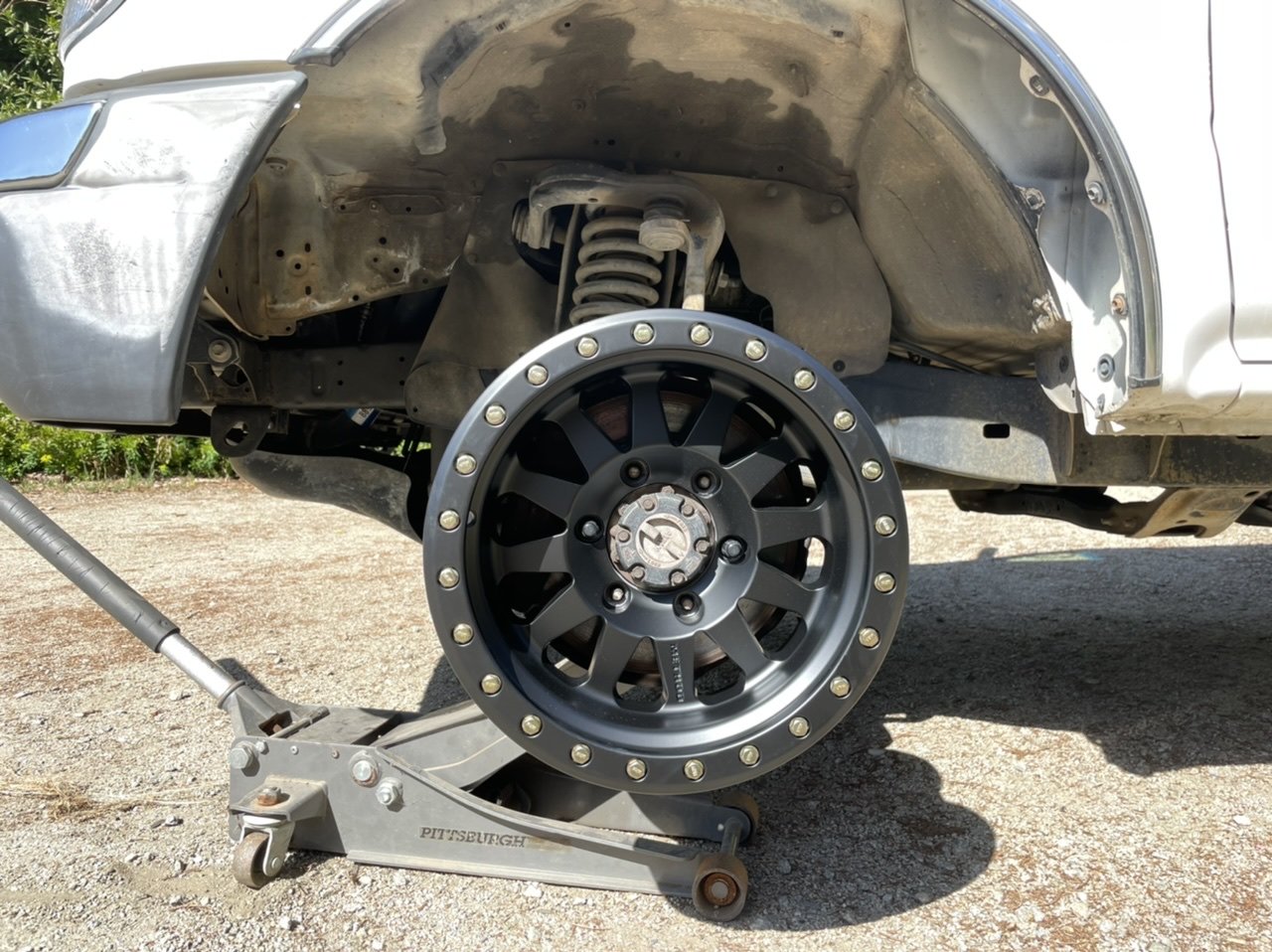

    15x8 Method Double Standards Fit fine. I think the back spacing is 3.5”
