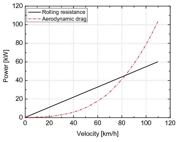

    See picture below. At some point you will push the truck to a lower gear/higher RPM because the truck can't generate the required force at the rear wheels to overcome the increased air resistance due to speed. At this point, if you can't understand this, I'll have to assume physics is beyond you or you are choosing to ignore it because it directly refutes your complaint.
    Relation-between-the-power-necessary-to-overcome-aerodynamic-drag-and-rolling-resistance.jpg

    That is a great chart. What assumptions is it making on weight and frontal area I wonder.? Do not take my math here as gospel because the assumpti9ns of the graph are unknown, they are illustrative and hypothetical.
    Converting this to American
    80mph is 128.7 kph. Off that chart in power requirements. Let’s just say it needs 167 hp to maintain that speed. You need to feed the horses.
    At 50 mph that is 80kph itrequires 56 hp. To go that speed. Mostly to overcome rolling resistance. Air becomes more of a problem nearing 55mph.
    So 122 more hp to go 30 mph faster. I wonder where the energy comes from?

    looki g at the resulting numbers I think that chart is off. Or it is for a much bigger heavier vehicle
    You can exp3ct a near tripling of power needed from 50-80 mph it I am thingkig the hp required for 80 should be closer to 50-55

    That chart needs no assumptions, just change the slopes to fit the values.
    Our truck needs about 57 hp in stock configuration to go 70 mph.

    It was a chart I found on the internet and is not for Tacomas. I used it to demonstrate that drag force is not a linear equation. The required energy to overcome change in drag force going from 20 to 40 kph is a lot lees than the change going from 90 to 110 kph.
