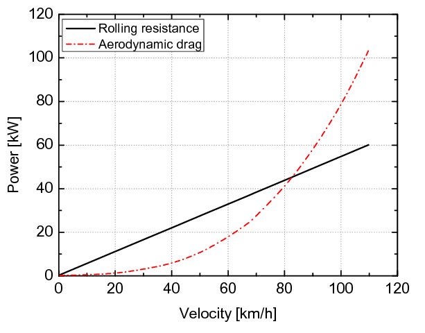

    The basic equation for air resistance (and the power required to overcome it) is non-linear. Drag=[(constant k)(velocity)^2]; there is a lot to the constant k, but it doesn't really apply here because that change is linear. As you increase the velocity (linear), the amount of force required to overcome it is exponential. Unfortunately designers/engineers can't change the laws of physics.
    Relation-between-the-power-necessary-to-overcome-aerodynamic-drag-and-rolling-resistance.jpg
