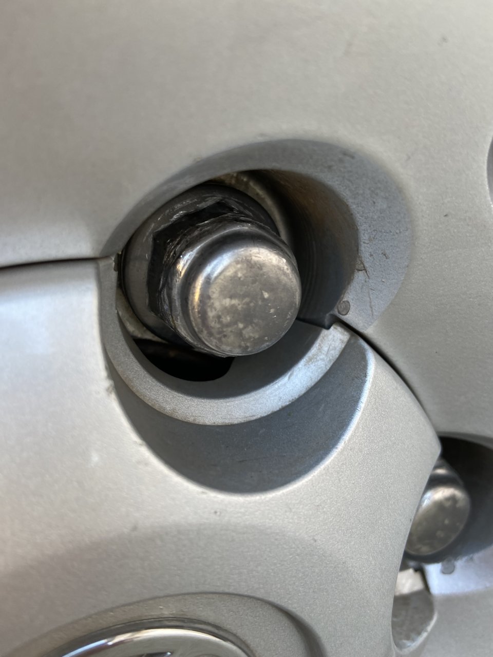

    Yes swollen lugs is actually a thing, especially in the rust belt.
    The factory lug nuts are an actual smaller lug nut with a stamped chromed cap on top the nut can corrode underneath and swell up under the chromed stamped cap to the point where the socket won't fit right and you end up using a bigger socket that will round it over.
    I have actually seen a cross threaded lug nut have the chromed outer twisted off of it by an impact.
    All that said however it still sounds like the dealer took you for a sucker.
    The tech should have noticed the lugs were swollen and then asked if you wanted them to continue before proceeding due to the possibility of damage or breakage.
    Instead sounds like they broke your shit and then blamed you and sent you the bill for their negligence.

    Tech was very rude and short with me when I started questioning about them. But hey what can I do they effed them all up before telling me.

    They haven’t replaced the lugs yet. Gonna question them more about it when I go back. I just don’t see how they could be “swollen” when it’s spent most of its life in the hot dry California valley, and less than a year parked inside a garage at the coast.

    Most shops use 12 point 13/16" sockets and air tools to work on the lugs which are skinned with a chrome cap as stated above.
    Buy some Amazon mag wheel lugs (sets come with 20 or 24 so buy based on 5 or 6 lugs per wheel). Just beware that all these are Chinese so if you buy black ones paint is thin and they will rust unless you spray them a few coats of satin or gloss black Rustoleum before installing then get yourself a 21mm 6 point deep socket. The acorn lugs are for steel wheels only. The mag ones are for alloys and look at the slight taper on the end so they work with the steel spare too. Size is M12x1.5 and head any size 1.5" long and up based on your preference.

    Swollen cap on a lug nut is possible, although stripped threads should not happen unless someone FUBARd the lug nut.
