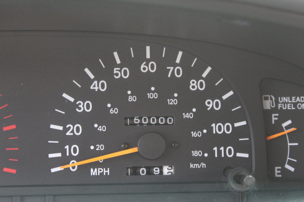

    why the wheel bearings?
    ... recently turned 150k on my OG 1st gen!
