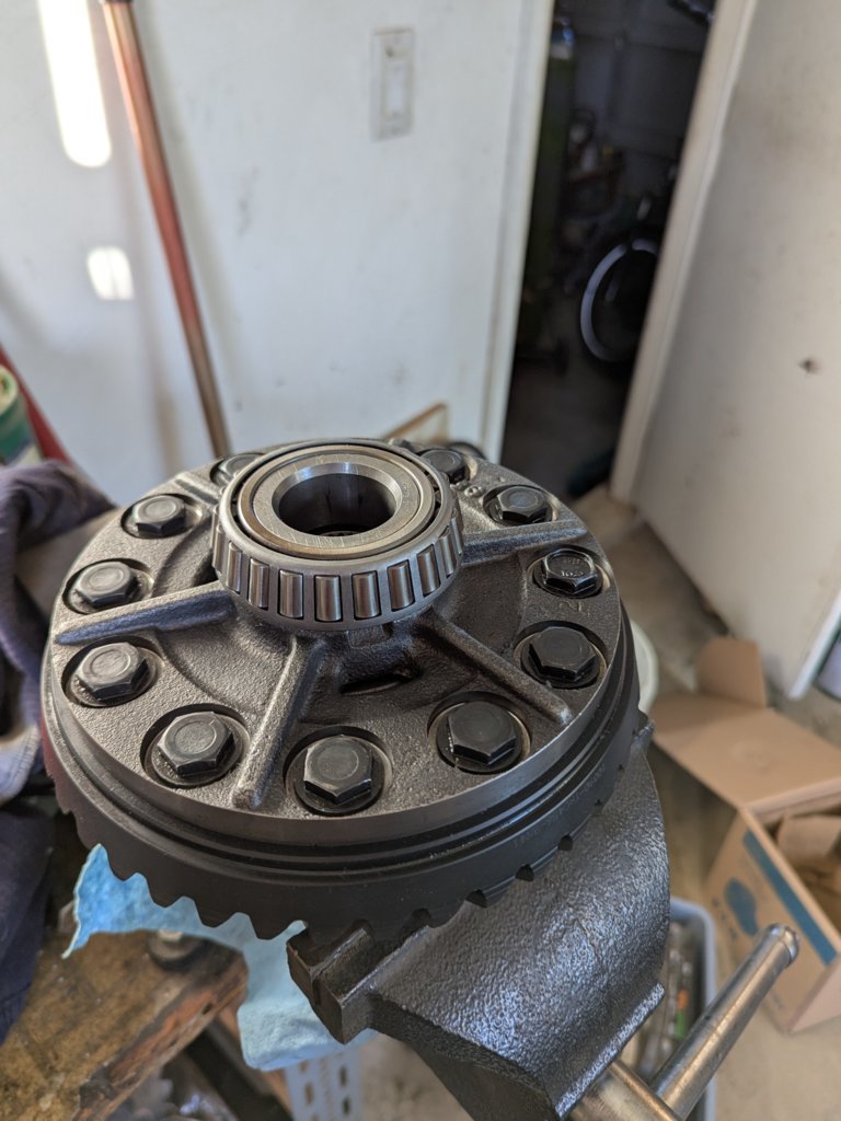

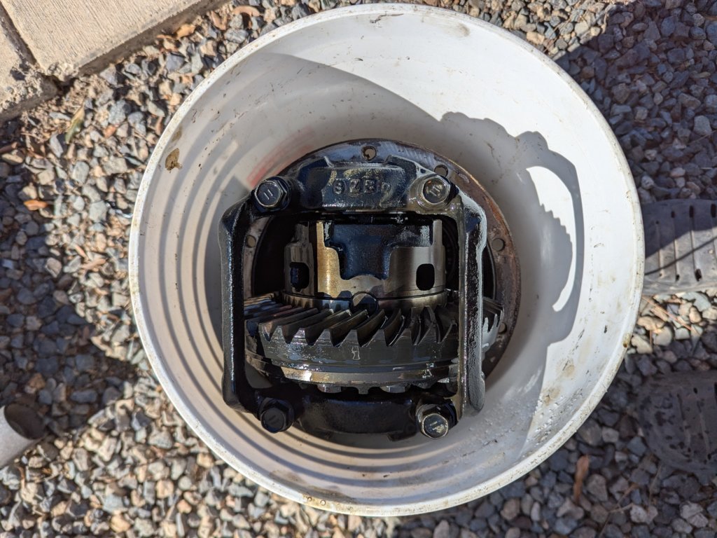

    Going from one tire fire to locked. Should have the diff back in next weekend.
    That super duty took me a month to get going. Man that project was difficult. My Toyota is a walk in the park.

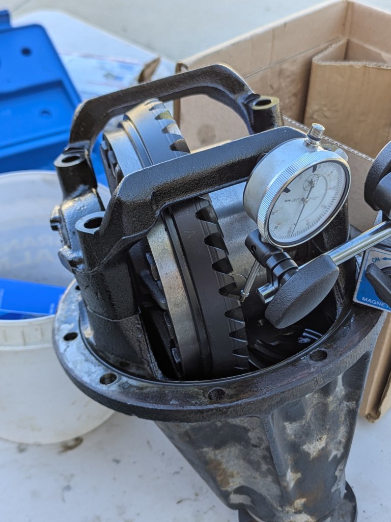

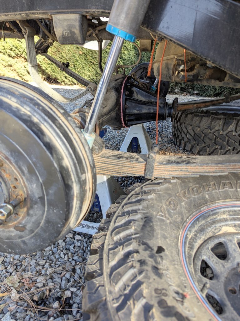

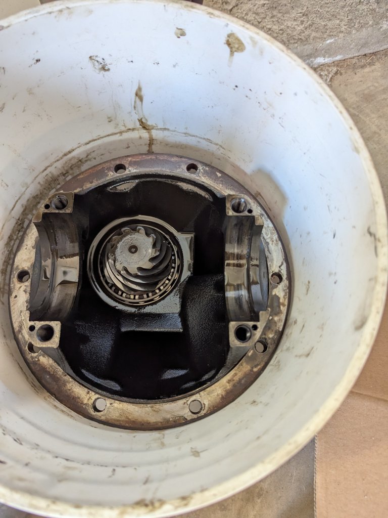

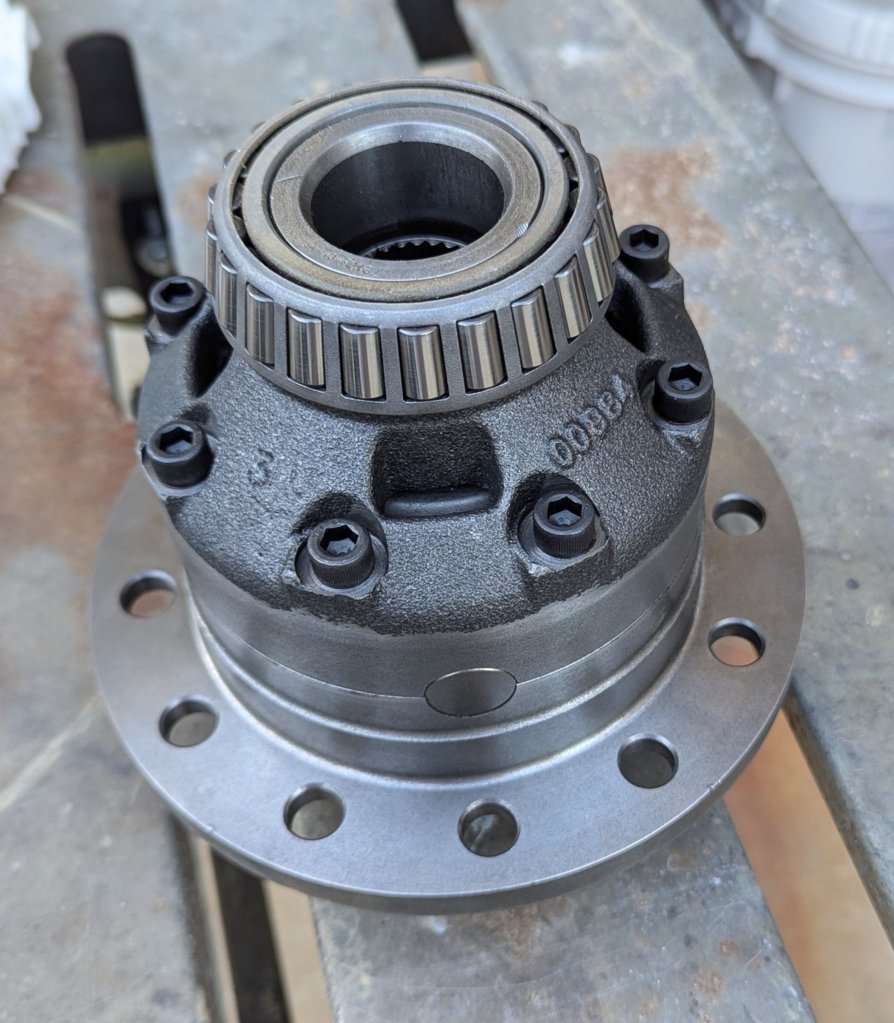

    Diff is back in. Didn't need to shim when moving the ring gear to the locker. Still at 0.008" backlash and acceptable contact pattern. Didn't take a pic of that because my gloves were gross. Just need to bleed brakes when I can get someone to help with that.
