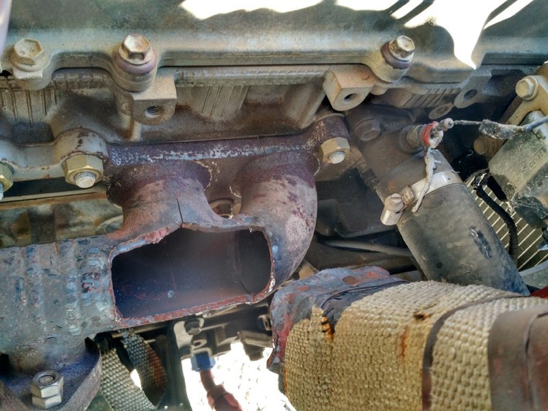

  11. Jan 28, 2017 at 1:52 PM
    #1231
    MadTaco461
    MadTaco461 [OP] BRO runner
    Dec 30, 2009
    #28470
    13,425
    CA
    99 turbo 5 lug long travel
    Kinda stock
    Mmm. Severed exhaust and melted sensor after cutting off the safety wire.
    nfs257 and Lord Helmet like this.
  12. Jan 28, 2017 at 2:22 PM
    #1232
    goblue82
    goblue82 Well-Known Member
    Aug 2, 2013
    #109601
    5,663
    The Dude Abides
    Southern California
    Click muh sig
    Oh wow. What's your plan of attack?
  13. Jan 28, 2017 at 2:51 PM
    #1233
    MadTaco461
    Dec 30, 2009
    #28470
    13,425
    CA
    Kinda stock
    Reweld it and figure out how to get a gusset to the flange. It's not going to be pretty.

  15. Jan 28, 2017 at 6:51 PM
    #1235
    noSKills858
    noSKills858 battlescars
    Jan 5, 2009
    #12256
    3,522
    Alex
    Poway, CA
    2003 5-lug Prerunner
    Couple shocks, some old tires, and a bad paint job
    Mine did that too. Going to build a new manifold with thicker tubing so I can get a nice fat weld on there with some gussets.

  18. Jan 28, 2017 at 8:00 PM
    #1238
    Lord Helmet
    Lord Helmet Prepare To Attack
    Aug 30, 2012
    #85875
    39,164
    Nick
    '24 X3 M40i
    Ahh gotcha :thumbsup: I had to brace my turbo manifold in my integra back in the day due to the constant vibrations. It didn't last when it wasn't braced.
