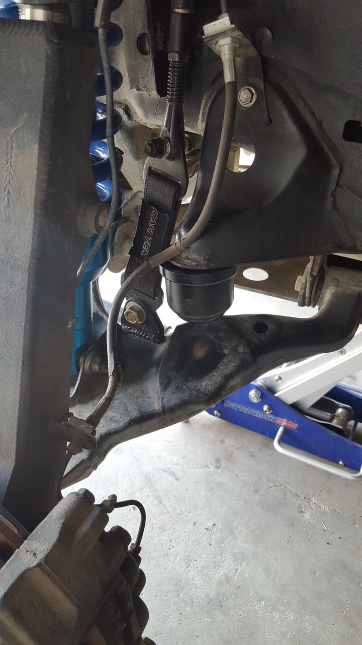

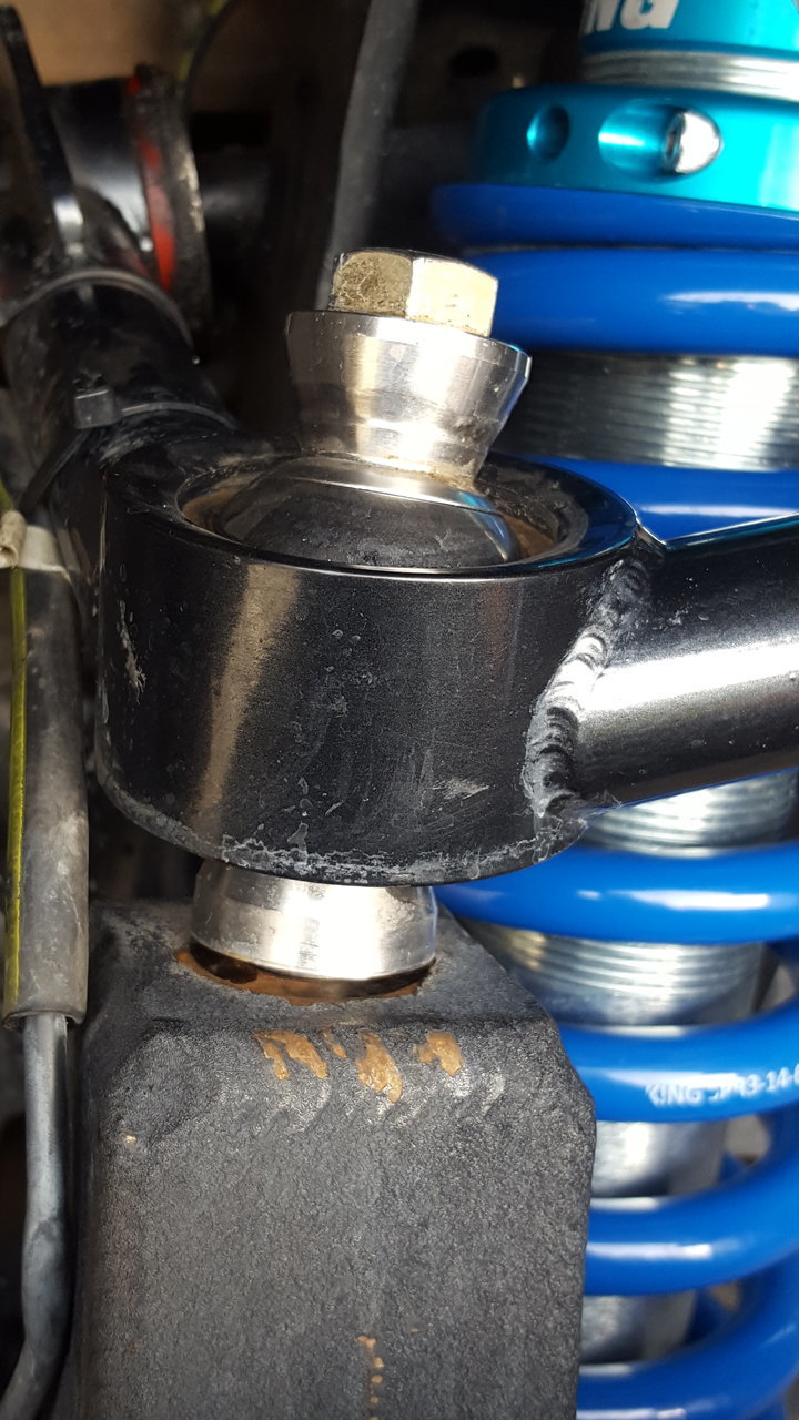

    Still time for carnage? It's either bent of broken. For the second time...

    Sure looks bent. Might want to cycle that side again to make sure you aren't drooping out too much or bumping too far. Or is it coming loose on you?

    Not really, had it strapped not to too ago. Most likely it's going to be soft polyurethane bumpstops

    The first time the bolt just broke on me while backing up to park. I made a thread of it. I'll look for it. The truck shop sold me the expensive ass misalignent spacers after that.

    I guess this are either too soft or I hit the woops to hard for non long travel setup. :rofl::cheers:

    I thought you were LT up front. Put a fender washer on your bump. Some of those whoops are big out there. I slammed into my bumps a few times out there.

    The first time it happened I hadn't been on the trails for a while, plus it wasn't even as noticeable as this time.
