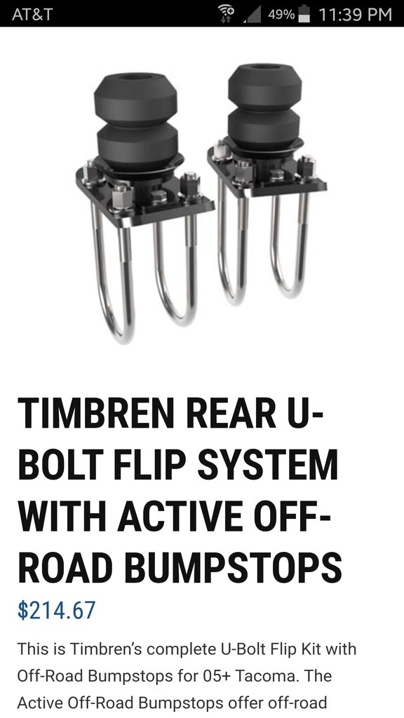

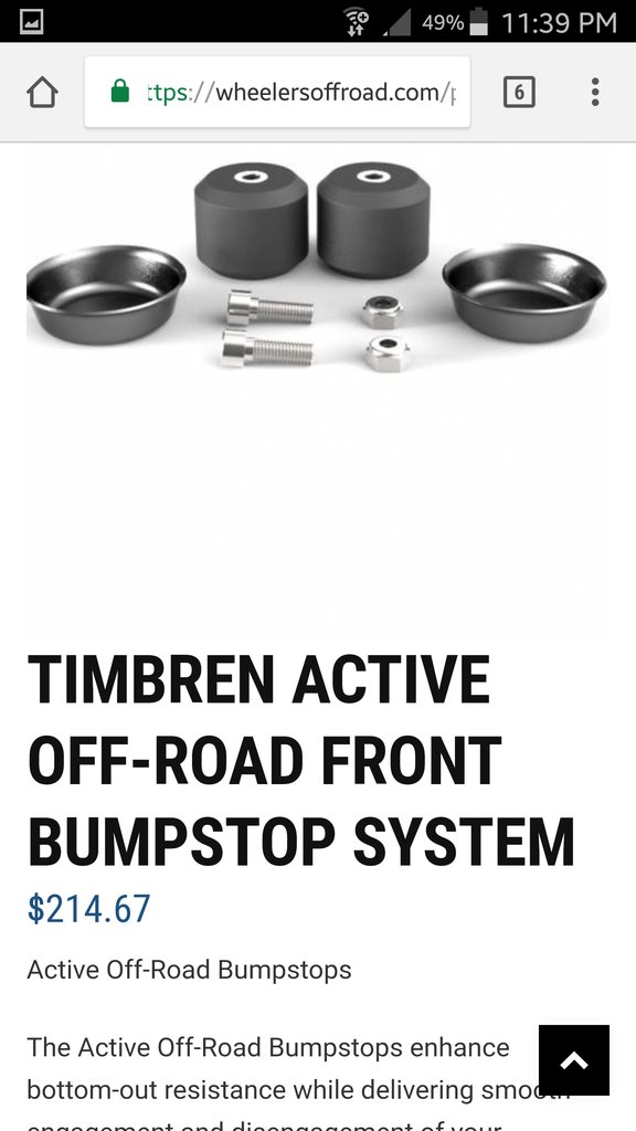

    My understanding is that Timberns are more than just a bump stop they can also help with load capacity for hauling/towing stuff. This is good if that is what you want to do but if all you want is to wheel then they have a tendency to push back. In other words they limit the amount of up travel more. Long and short is if you just want to wheel get the Superbumps, if you want to tow without the sagging get the Timberns

    Too much money. The super bumps are 200 less.

    You could use hockey pucks for bump stops... old member XXXX used something like that. Not actual pucks but hard rubber and he cut it the length he needed

    What trail is this?
    But squish less.
    Yeah if you want to feel like your suspension hits a fucking brick when you go to full compression. Going slow that's fine but if you want to do anything a little faster or even want to know you hit full compression without losing a filling, a gradual compression bump is the way to go.

    Timberen bump stops
    I am using timberen bumps, and I love them! with the dakars, ATO shackle flip and B110 shocks, my leafs go barely negative at full bump.

    I run Timbren in the rear also but I have j66 leaves that don't have an overload. So just in case i do haul something it might help out.

    I have superbumps on the rear, and a set for the front sitting on the shelf.
    Definietely worth it.
