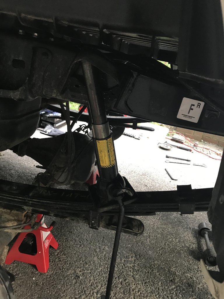

    Dont bother doing the shackle flip with those shocks. Either return them and get 12" travel rr and shock relocate, Archives relocate and 14" Kings, or keeo the ones you ordered and dont bother with the shackke flip.
    To be honest, I dont see you ever doing more than green trails anyway, so a shackke flip and longer shocks are not really needed.

    I don't have a shackle flip. It's not necessary. It just gives you a little extra lift/travel. Did you get your rear shocks set up for dakars? They should be about an inch longer than the extended travel ones I think.
    Blackout14 likes this.

    I'm not running bump stops in the rear.

    You mean aside from stock bumps? or none at all? How are you keeping the shocks from bottoming out?

    None at all. 14" shocks, dakars with shackle flip only have 12" travel

    I had to put a hydraulic jack between my frame and the leafs to push the axle low enough to get my shocks on. Another two inches might not have been manageable

    I had to do something similar when installing my rear lift. Just couldn't get the shackle to line up otherwise. Worked great!
