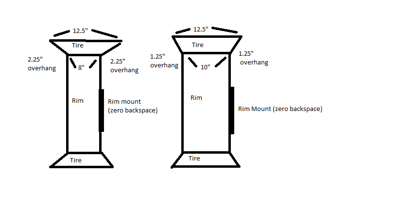

    Here I drew a picture for you.
    Both of these rims have zero backspacing, for simplicities sake. Both have 12.5" tread tires.
    As you can see, in the setup on the left side (8" wide rim) the tread hangs over 2.25" on each side of the rim (therefore it hangs over 2.25" over the inner bead seat).
    On the right setup (10" wide rim), the tread hangs over 1.25" on each side. (1.25" over the inner bead seat)
    Therefore, on the 8" wide rim, the tires will in 1" closer to the UCA than on the 10" rims.

    Are you serious? Explain to me what part of my diagram didn't prove you wrong. Do you just not understand what we are trying to say here?

    The tread width is not going to change...it will remain 12.5" wide....but it's position will move in 1" closer to the uca. That's what my diagram is showing. I'd like to see how you see it differently.
    If he's rubbing on outside of the tread, moving to a 8" from a 10" rim may well cure the rub, because it moves the centerline of the tire in 1".
    You can't just "suck the sidewall in" on one side only.

    OP: Does the diagram I posted above make sense to you? We kind of got caught up in all this arguing, just wanted to make sure you were following....

    yea it makes sense to me thank you for posting that up. i was just sitting back watching while yall were going back and forth.lol
