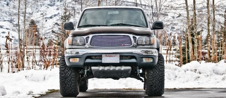

    wanting to drop from 16" wheel to 15x10 wheel with 3.75"backspacing and run 33x12.5/15 tires I have 6inches of lift on 2001taco . I see people with 15" wheels but no specific info. will the clear the calipers? any rubbing issues with the 3.75" bs and is it enough bs?? any pics with the same set up? thanks for any help with this.

    15x10s 3.75 BS
    180438_10150138601925530_549380529_85921_2db5d1ffa4fc694ba55b3abbd376a890597ae6ed.jpg
    thats Jerry's truck before he SACed it.
    with 3.75'' on a 10'' rim you could still rub on the frame a bit at full steer lock.
    you'll have no issue clearing the brakes with a 15'' rim. base models came with 15s and 16s weren't used till 01 i believe for standard wheel.

    thanks blackdawg. that's the look I been wanting

    Yea 15x10s give a wider look. Most run 15x8(myself included) as they give you a tad more height and are better protected from rock rash when wheeling.
