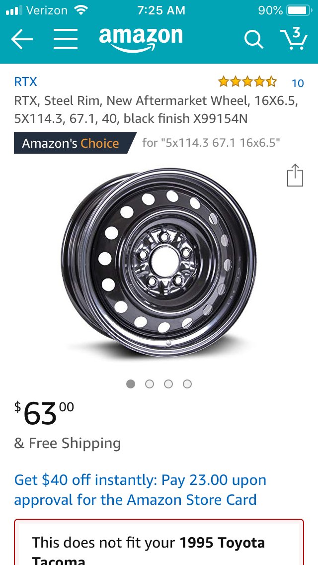

    Would this work?
    Amazon says it won’t (also shows both 6-lug & 5-lug rims as fitting).
    Should I risk $60 on one?

    JKO1998
    JKO1998 Well-Known Member
    Jun 2, 2015
    #156578
    53,030
    Utah
    No link :redxfall:
