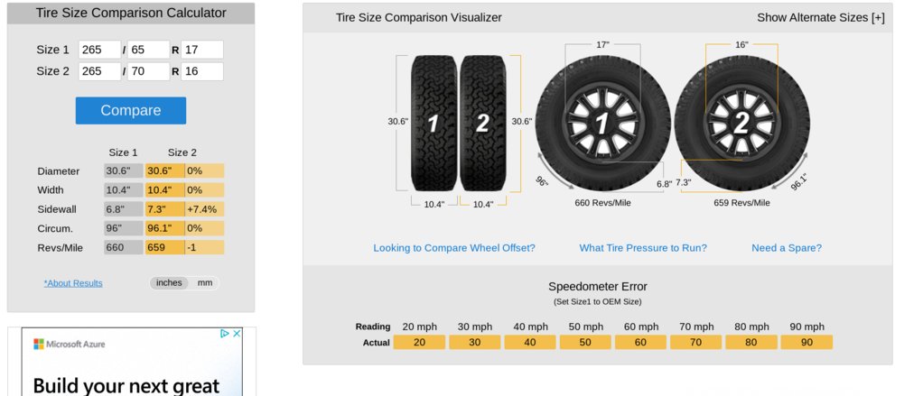

    A 265/70/16 is almost identical to the stock sport tires in height and width, see the comparison below.

    Changing rim size fro 17" to 16" has nothing to do with the speedo reading. Tire size choice will though if the tire diameter is different than stock. :thumbsup:

    the speedometer does not know what size wheels are mounted......only the tire size matters
