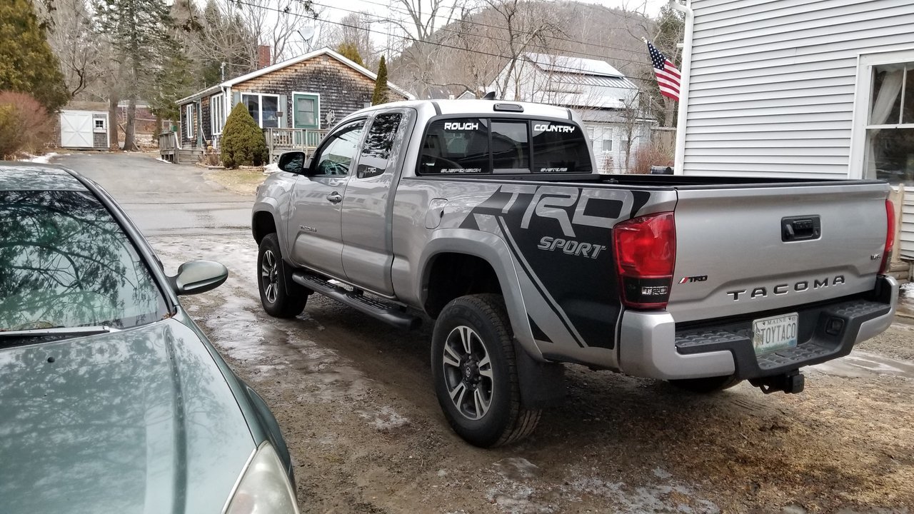

    I am glad they took care of you. I also think it’s amusing that they “discovered” your lift, when you have a “rough country” decal on your window. I don’t know if you were trying to be funny, but that’s funny. Well done.

    I just got the call from my dealership and my "New Differential" install is scheduled for March 28th. They said the tech that does these installs is on vacation for the next 14 days. I said yes I know he is....Service guy said "What"? I said to him I know your Lead Tech is on vacation , I'm married to his oldest sister. Ya my brother in law has been with this Toyota dealership for 35yrs now. He's the one you want fixing your vehicles. Got to wait 5 more weeks. Oh well kinda getting used to the vibration....NOT !!!! At least its minimal.
