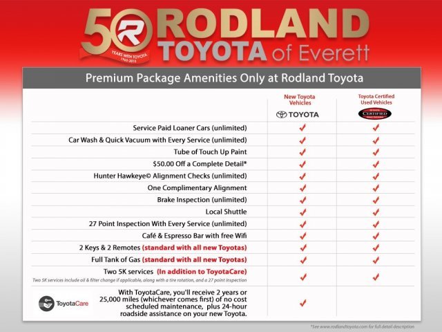

    Yeah. They have been excellent so far on both sales and service. Well, for whatever reason, they did not do the 5k oil change yesterday. That was part of a dealership thing over the Toyota Care (two free 5k oil changes). I'm not sure what was up, but I am happier about the bearing and will either have them do it with the TSB or do it at home.

    That actually is normal. Oil change happens at 10k and 20k.

    Yes. I am fine with 10k intervals. It was just a nice-to-do for the first change. Like I said, I'd rather get the needle bearing done.
    Maybe it was the 'if applicable' fine print? Either way, I'm good to go.

    That's cool. Lots of people aren't aware of the oil change schedule.
