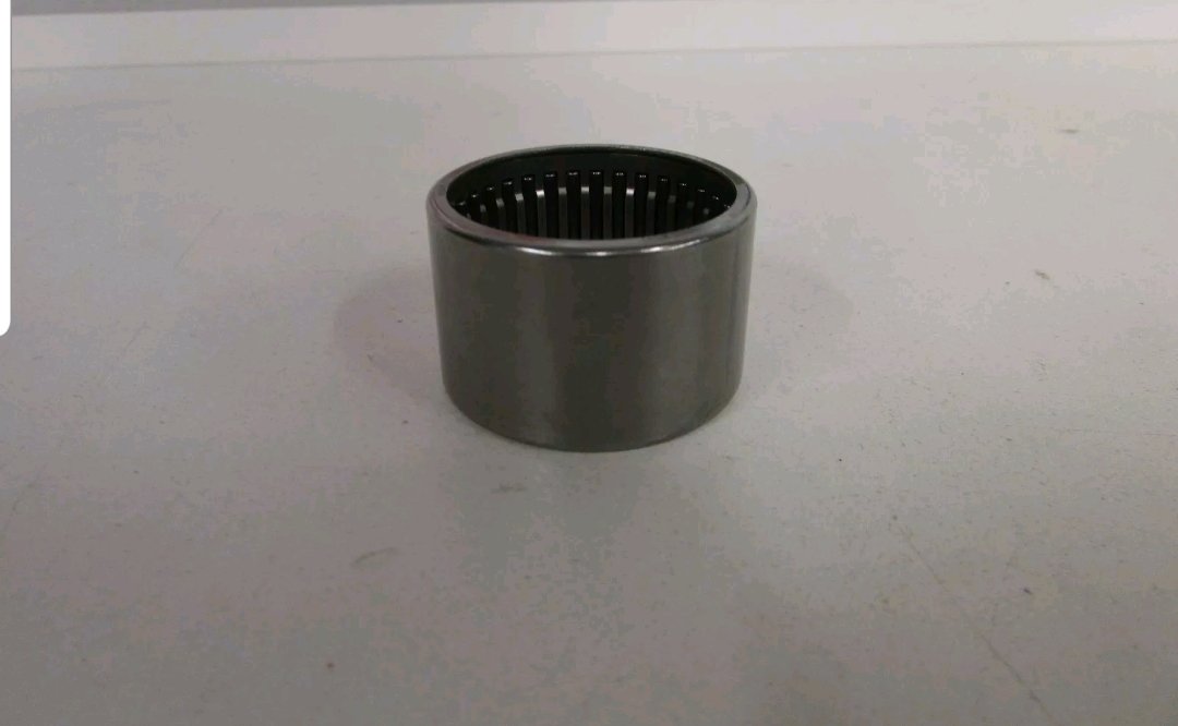

    That is the outer (wheel bearing) not the one, that is causing problem. It's the inner needle bearing, in diff that is causing the problem.

    Needle bearing, then bushing. Needle bearing is like $19

    Does anyone have the OEM part number for the needle bearing?

    I probably got it in my glove box still. I'll try and look at lunch. Sure somebody knows it off hand and will beat me to it

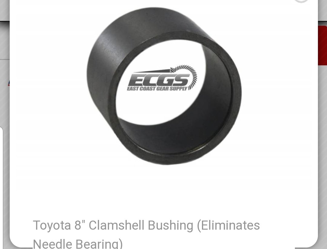

    Dealer wouldnt replace mine because of 2 inch lift. Put ECGS bushimg in my self on Saturday...

    That's BS. Dealer did mine no problem. Kick em in the nuts
