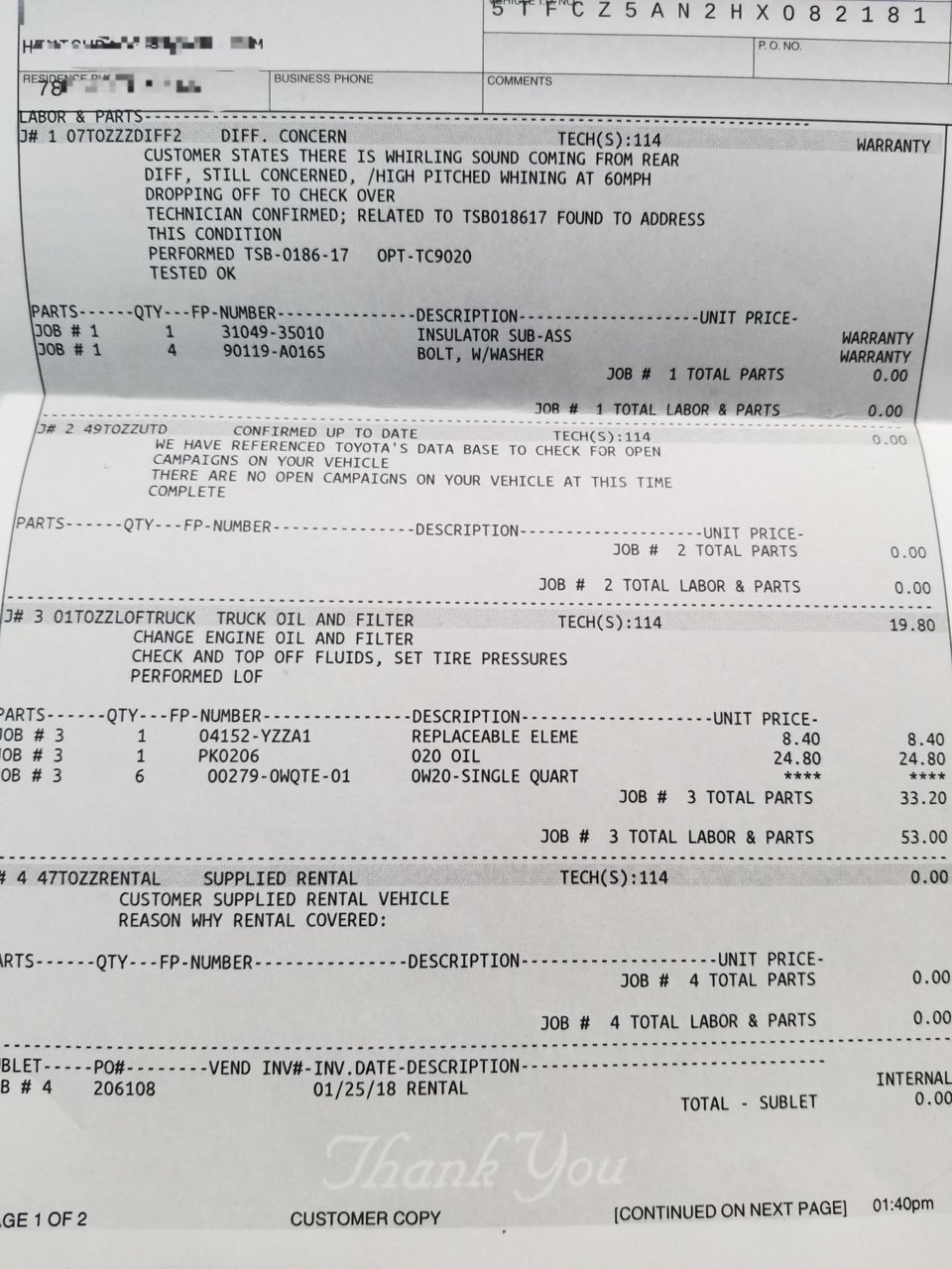

    Yes. Thick green pads by the transmission.

    These are the most recent records I have of diff service. My question is how did they hear tire noise with it running in the air?
