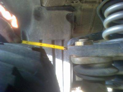

    I have the KMC XD Hoss wheels 16", Light Racing UCAs with 285s.
    4.5" backspacing, lug-centric (though I'm told the hub-centric Hoss fits).
    Clearance:

    Thanks! Exactly what I'm looking for!
