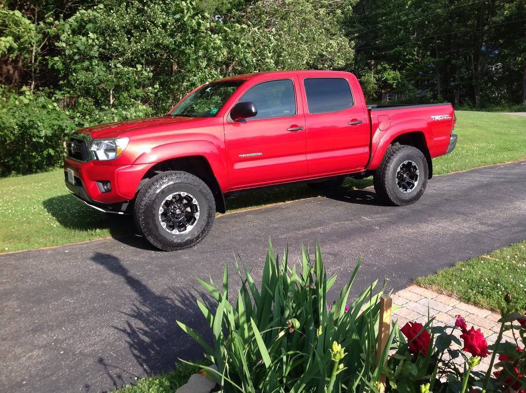

    16s fit my 2013 Off Rd just fine however Dick Cepek's only advice was that 17's will work just fine but 16s are questionable and a test fitting is required?
    Not being able to find a place that carried these rims here in Maine I thought I was SOL until I found the rims I wanted on Amazon with free shipping and no hassle return policy :D
    Good Luck with your choice

    Dick Cepek Torque, 16x8 with 4.5 Back Spacing.
