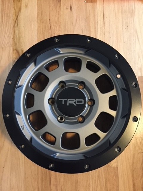

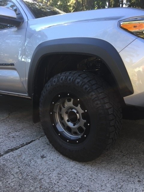

    I love mine. I think I paid around $220 each. I painted the trim ring and the center cap satin black, and then used some SSM TRD vinyl letters (they come in lots of colors).

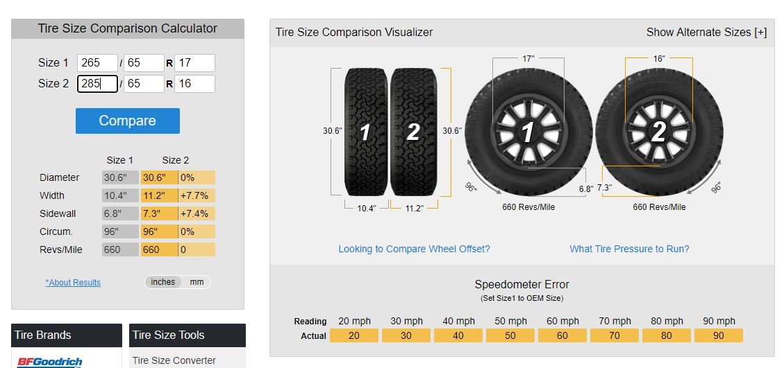

    So this appears to be the new tire size if I swap from a stock 17 inch wheel to a 16 inch TRD Beadlock wheel.

    Actually there are no tire sizes to match this other than a single $360 per tire VAN tire. Not off road or all season.

    265/70-16 or 245/75-16 is the OEM tire size for a 16” wheel on a Tacoma depending on trim level. The average 265/75-16 tire will fit with maybe an occasional mudflow rub but hardly anything you’ll notice. A 285 tire on a stock is asking for headaches.
    If you don’t care about off-road, something like the Michelin LTX is probably good as it’s a more highway biased tire.

    So you suggest the 265/70-16? I'm looking for something that will last at least 40k miles, great in rain and "OK" for off road, if needed.
