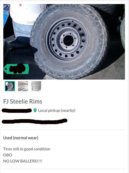

    I have a line on a set of FJ Steelies, with tires (265/75/16) for a really good price. Problem is the seller seems to know nothing about them... Wondering if you folks might be able to help.
    From what I can gather from the pictures, the FJ's are 16s". Internet tells me stock FJ dimensions are pretty much either 16x7.5 or 17x7.5, with a 15mm offset.
    I'm currently running a 2018 SR Short-Bed with stock Wheels (16", 25mm Offset) and stock tires (245/75/16), no lift.
    Assuming the FJ's are Genuine, would these fit my truck?
    Will I run into issues with the difference in the Offset between the FJ's and my Stock wheels?

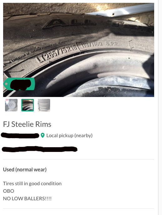

    Would it be possible to swap out the 265/75/16's with my 245/75/16's?
    Any advice helps!
    Pics below
    Pic of the Wheel from the post

    Tire pic from the post

    My random guy on the internet guess is that they will fit. Both 265/75/16 and 245/75/16 should fit fine on a 7-7.5" OEM rim. All of those are listed on the internet as stock sizes in various trims; welp 265/75/16 is 1" taller.

    Yes these will fit. FJ steelies only comes in 17s . The FJ 17s will come with metal center hub caps.
