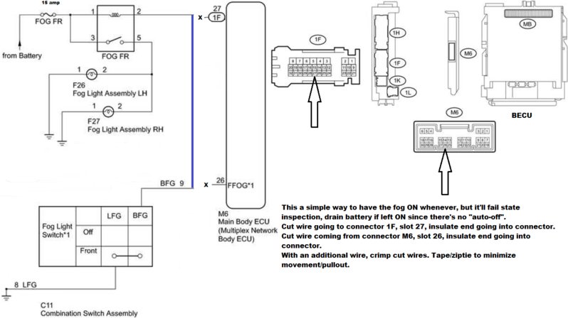

    Anyone have a pic where the ecu is? Or the BECU?

    Has anyone done this and wired up their fogs like this? I was thinking about wiring it up similarly, but this definitely is a better setup. @caribe makaira have you done this with your fogs? Basically wanting to know if it works, and doesn't set any warning messages?
    And thanks for the write up!
