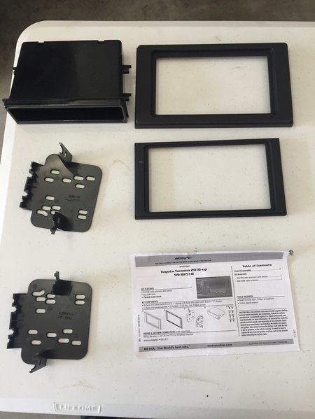

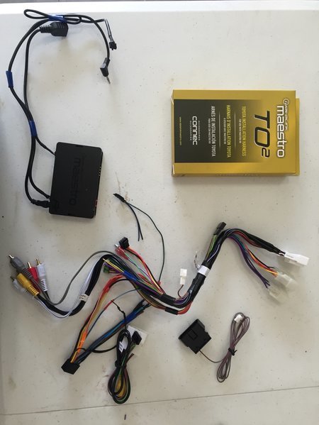

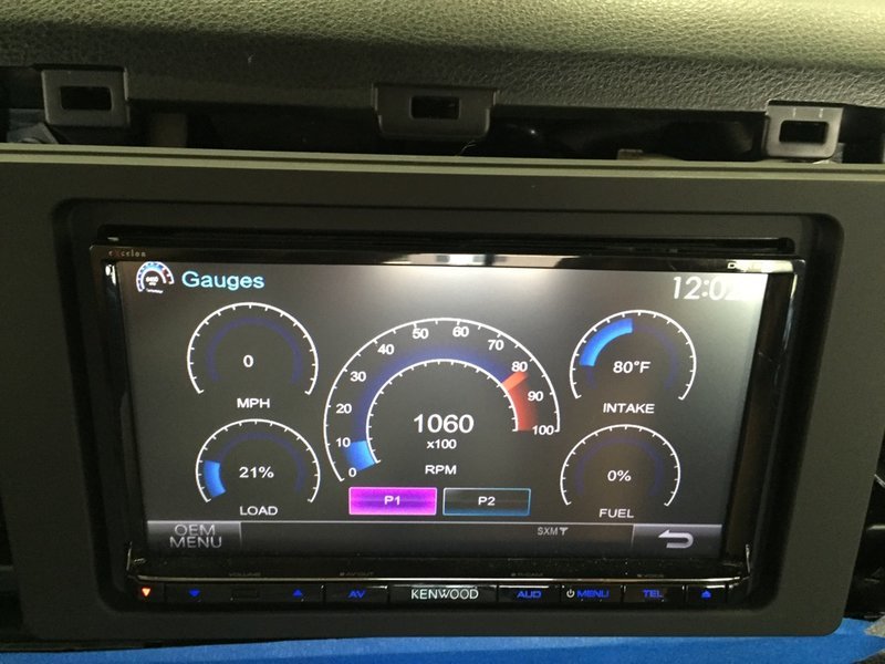

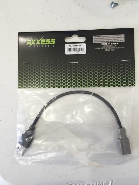

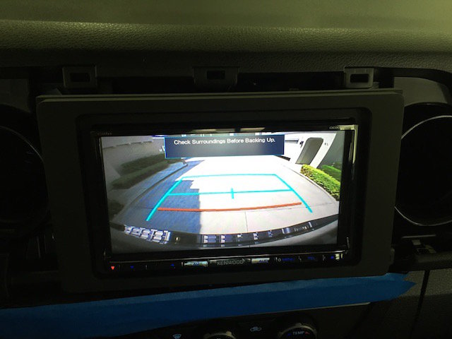

    So I've been searching the forum for a while now and either I am missing it or no one has replaced their 2016 JBL head unit using an iDatalink maestro. What I was looking for exactly was if the new headunit would keep all of the vehicle settings, and more importantly would I be able to change the vehicle setting such as light time out, door lock setting, etc. I tested this concept with an old system I pulled from a mustang I traded for the tacoma. This was strictly for proof of concept. It appears that all the functions are retained with the maestro. All steering wheel buttons worked, setting were accessible, backup camera worked, and now there were gauges added. I didn't test for long, as I said this was strictly proof of concept. Here are some pics of the pieces I used. Also note there was no modification to the truck, this was all plug and play. IMG_0157.jpgIMG_0164.jpg IMG_0158.jpgIMG_0154.jpg

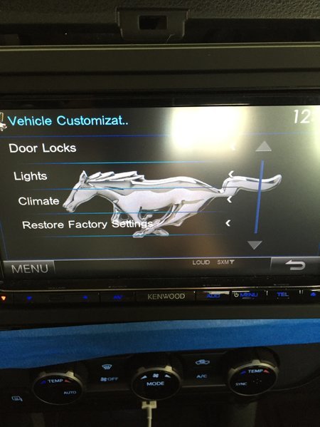

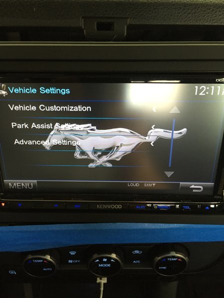

    Well then I retract this thread. It worked like crap and you don't want it....
    The whole reason of the install was I can't stand the Entune OS. I've also have the rebooting radio issue that Toyota "can't duplicate" Surprisingly it was a pretty easy install and with the exception of the maintenance menu most all the functions were there.

    Glad my post helped. Keep in mind that YMMV with each headunit manufacture. From what I understand Kenwood and Alpine support vehicle integration really well, pioneer on there other hand does not. I plan on getting a pioneer AVIC-8200NEX in a few months, I prefer Pioneer over Kenwood. I kind of want to see how well the integration is on pioneer's newer units.
