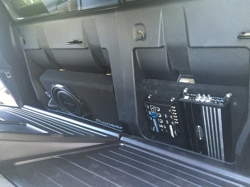

    I know it's been done. There's a guy selling one right now in the for sale section. I cut a piece of mdf to fit behind the drivers' side rear and covered it. Mounted an amp and LOC on the board and fit a sub in the other side. Replaced speakers, wired it up and good to go.
