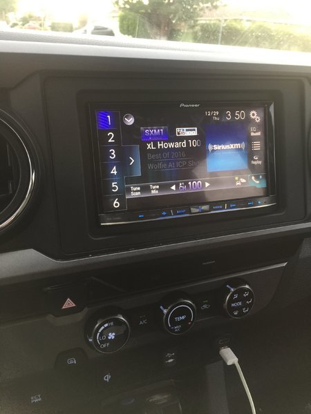

    Had this all put in yesterday. Only played with it for an hour last night. All functions from the factory work. The instulation kit looks like it came from the factory. Thank God no more Entune!

    @jimburnz Nice choice on the head unit. I'm waiting to see if Pioneer announces the Avic-8300 at this years CES then I'll pull the trigger on that one. I still have the Kenwood in place till then. Curious, did the installation shop give you the option to keep the in dash USB and use the secondary USB? There is an adaptor for the in dash USB, and If you have SiriusXM there is an adaptor of for the stock antenna. Idatalink just came out with the adaptor for sirius, it's the acc-SAT-TO2.

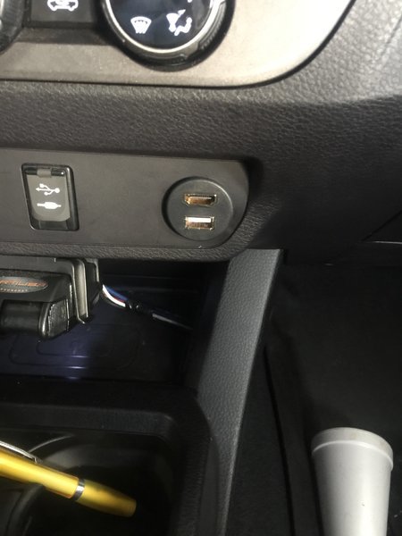

    The USB drive was not saved, (the installer tried, but failed) had to add a second USB with an HDMI. Also added a new Sirius receiver. I read about the adapter after the fact. No big deal got the receiver for 80.00 bucks & had 3 months free with activation. In total with transferring cost me about 30.00 bucks.

    For future reference for anyone that wants to keep the USB. This Adaptor from Crutchfield will work. Part number 120TOYUSB

    IMG_3181.jpgIMG_3180.jpg Very happy Entune is no longer available to me!
